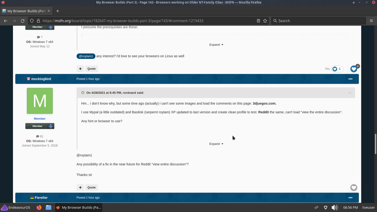

mockingbird Posted May 26, 2022 Posted May 26, 2022 On 4/28/2021 at 4:45 PM, rocknard said: Hm... i don't know why, but some time ago (actually) i can't see some images and load the comments on this page: 3djuegos.com. I use Mypal (a little outdated) and Basilisk (serpernt roytam) XP updated to last version and create clean profile to test. Reddit the same, can't load "view the entire discussion". Any hint or browser to use? @roytam1 Any possibility of a fix in the near future for Reddit "view entire discussion"? Thanks sir
Fierelier Posted May 26, 2022 Posted May 26, 2022 @mockingbird Try replacing "www.reddit.com" in the url with "old.reddit.com" 1
mockingbird Posted May 26, 2022 Posted May 26, 2022 2 minutes ago, Fierelier said: @mockingbird Try replacing "www.reddit.com" in the url with "old.reddit.com" Yes, I do that currently, but a fix would still be nice.
Fierelier Posted May 26, 2022 Posted May 26, 2022 I think it's not an important fix for as long as this solution exists. I've made a greasemonkey script that automatically changes these URLs, if you're interested: https://git.lumen.sh/Fierelier/fiers-grease/src/branch/master/Reddit - Old layout.user.js - Just click on Raw on top of the code to install it. 1
