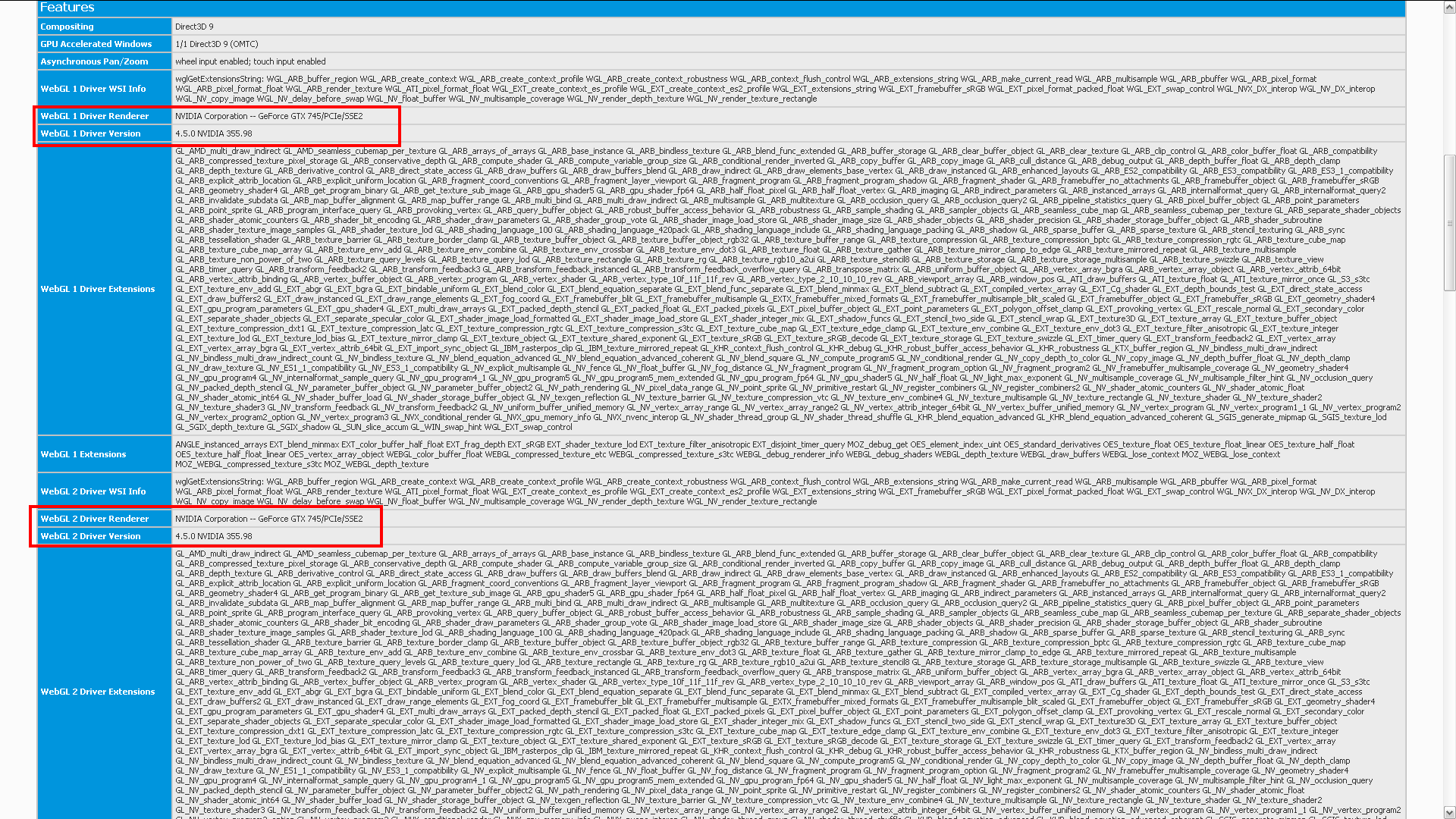

mockingbird Posted May 22, 2022 Posted May 22, 2022 (edited) On 5/20/2022 at 10:27 PM, UCyborg said: Throughout the years, speaking from my own experience (FX->PM->FX->Basilisk->PM), it often felt like the codebase is held together by duct tape, eg. memory leaks continue to persist. You close all tabs, but the browser process still holds hundreds of megabytes of RAM. Or take Scratchpad editor's "Pretty print" function for instance, broken that it often breaks the code or craps itself; doesn't understand "let" variable declarations (very common!) and "`", there could be more valid characters / words. This doesn't make sense, ANGLE enables D3D9/D3D11 output (only former usable on XP), with "webgl.disable-angle" set to true, OpenGL is used, not D3D9 or D3D11. Please see these screenshots: Serpent: MyPal: On a side note, I would like to make a feature suggestion that D3D9 be hacked into Mypal68 if possible... Notice that in Serpent, the compositor is set to "D3D9", but on Mypal it is set to Basic, since Firefox Quantum had D3D9 removed and replaced with D3D11, which is not available on XP. Edited May 22, 2022 by mockingbird

UCyborg Posted May 22, 2022 Posted May 22, 2022 4 hours ago, mockingbird said: MyPal: Yes, ANGLE is active here and WebGL2 can't work with D3D9 feature set AFAIK. Is that with webgl.disable-angle = true? It may only work by also adding layers.prefer-opengl = true, which forces OpenGL for general webpage compositing and has its own quirks...not exactly the same as with St52 where you can keep D3D9 for webpage compositing.

mockingbird Posted May 23, 2022 Posted May 23, 2022 7 hours ago, UCyborg said: Yes, ANGLE is active here and WebGL2 can't work with D3D9 feature set AFAIK. Is that with webgl.disable-angle = true? It may only work by also adding layers.prefer-opengl = true, which forces OpenGL for general webpage compositing and has its own quirks...not exactly the same as with St52 where you can keep D3D9 for webpage compositing. With Mypal, no it is not using OpenGL as the compositor because it is quirky - as you say... Everything is shifted up when this is enabled, and it is not functional. Oh well, that's a deal killer for me... If D3D9 could be backported to Mypal 68 then it would be ideal... for now I'll stick with Serpent... He fixed a lot of stuff in the last release and it is running well.
