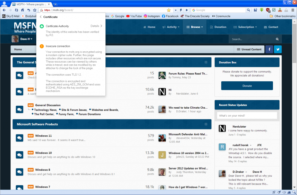

XPerceniol Posted June 24, 2022 Posted June 24, 2022 (edited) Actually, I also didn't realize (forgot) that I'd already removed --kiosk-printing from the loader quite some time ago, but if @NotHereToPlayGames put it in there, perhaps there is some security risk involved on Print Preview I'm unaware of. Yeah, must be a changed in V13, but what I'm surprised about, from looking at your screen grab, your connection to MSFN is in red? This never happens on V11 with Certificates Updated from the tool here. Are you able to get a secure connection? This was happening all the time in @Humming Owl 's DC Browser (which I gave up on ... too bad, it was very nice) and V12 I had the same with no benefit over V11, and I still will use V9, as well because it uses so little resources and still renders videos properly; shockingly. Edited June 24, 2022 by XPerceniol
Dave-H Posted June 24, 2022 Posted June 24, 2022 The connection is like that if I use a direct connection to the net, i.e. no proxy. If I switch to using the IE proxy, which is via ProxHTTPSProxy, it's fine, but the proxy connection slows down the connection considerably, so I don't use that configuration in 360Chrome. In the case of MSFN, it looks as if it doesn't like the fact that there is apparently insecurely delivered content on the page. All my system certificates are up to date.

Dave-H Posted June 25, 2022 Posted June 25, 2022 6 hours ago, rereser said: insecure connection on MSFN ... if cloudflare is not blocked somehow (noscript) then it will show "insecure" connection. cloudflare and other ECC certificates are not supported in win xp. in v12 and v13 360chrome versions that results in a red https padlock. v11 360chrome will present a green padlock but connection remains "insecure". it is just hidden by the browser so the user feels safe. test : https://www.cloudflare.com no certificate updates will solve that. Thanks, I guess I won't worry about it if nothing can be done about it! As I said earlier, it's fine if I connect via ProxHTTPSProxy. I don't like the speed hit if I do that though.
