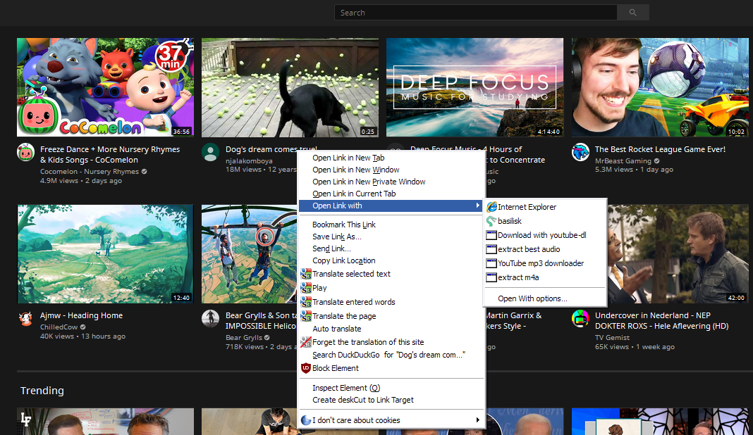

I use yt-dlp (fork of youtube-dl), which supports downloading from more than 1000 supported sites and from a lot of unsupported sites with the generic extractor.
I integrated it in the browser context menu with the help of the "Open With" extension (can be obtained via CAA).
Very convenient!
