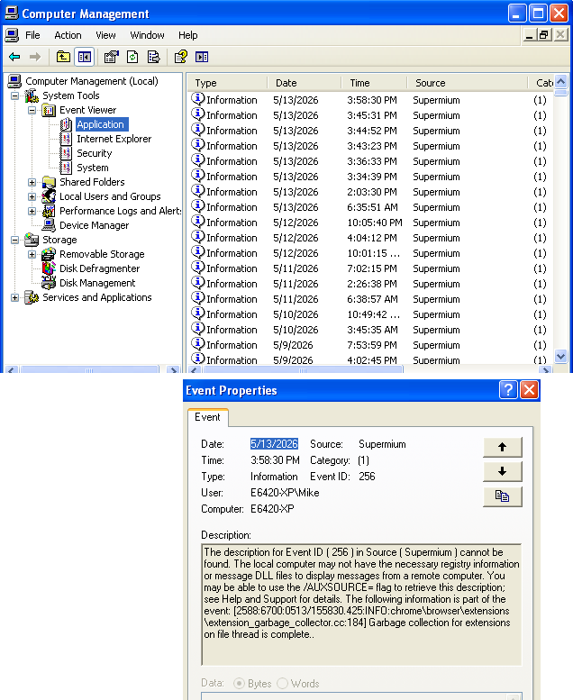

Hey there guys have a question. im not sure if it's been answered already, but i have tried googling all about this and cant find any answers anywhere specifically. Every time i open the browser, or close it i think... it keeps logging this error message in the event viewer about "garbage collector".
https://i.ibb.co/xS3dSf9H/event-256.png
id just like to know if there's any possible way to stop this from flooding the system events (application) every time i open/close the browser. The only thing i noticed is if i disabled all extensions... which i only have just 2 - "no script" and "animation policy" which stops animations from playing on most webpages. -- if i turn off both of them, then the error never seems to appear in the system event log - but just turning on 1 of them - doesnt matter which, then the error always appears like in the screenshot above.
I cant for the life of me find any answers on how to stop that message from appearing for good without disabling those 2 extensions, but is there another way though ??

8 minutes ago, kuja killer said:
"animation policy"
Great one!  I use that too!
Does the below file exist in your profile?
Can you open it in something like Notepad++?
I kind of have to suspect that *any* extension causes this on your setup.
That it has nothing to do with what extension.  Install *any* extension, even just as a temporary test, and you still have this error.
I'm not getting it on my test Supermium, but it's also in a Win10 VM and not in XP.
Hopefully another XP users stops by and looks at their event viewer logs, maybe they have this issue too but just never noticed it yet.
Edited by NotHereToPlayGames
dang :( umm well i dont see any "chrome" folders or that directory anywhere -cause there only just named supermium -  but i did look through them - and i turned off like "hide protected operating system files" - and turned on the "show hidden files/folders - and looked in the documents and settings\username\ - application data folders for any hidden folders and stuff, but no such thing at all, so dont see this "garbage collector.cc" anywhere. - and already looked in the main supermium program files folders and stuff, nothing there about it. unless it's really actually hidden somewhere but i dont know
Edited by kuja killer

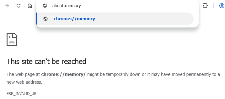

about:memory - buttons GC and CC shows these words in other browsers maybe Supermium the same

I have the Windows event log message about garbage collection on my 32-bit XP Supermium installation too every time I run it, but it's not there on my 64-bit Windows 10 Supermium installation. Whether that's because it's a different 'bitness' or it's on a different operating system, I don't know.
There used to be a message in the event log on all versions saying that 'the client isn't registered' every time I ran Supermium, but that has now gone away.
Check if you have a "Supermium" entry in your Registry in these locations:
[HKEY_CURRENT_USER\Software\Microsoft\Windows\CurrentVersion\Run]
[HKEY_CURRENT_USER\Software\Microsoft\Windows\CurrentVersion\RunOnce]
[HKEY_LOCAL_MACHINE\SOFTWARE\Microsoft\Windows\CurrentVersion\Run]
[HKEY_LOCAL_MACHINE\SOFTWARE\Microsoft\Windows\CurrentVersion\policies\Explorer\Run]
IF you have, deleting it might fix your event viewer problem.

4 hours ago, Dave-H said:
Not there for me, and I'm not at all sure why any of them would be.
:dubbio:
Agreed, same here.  Nobody "should" have any of those entries.  They would have had to manually add them.
