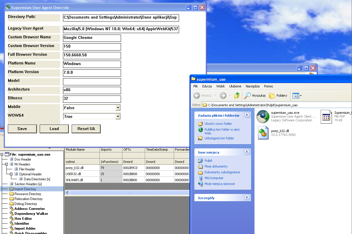

The error I'm actually getting on XP is -
"Entry Point Not Found : The procedure entry point InitializeCriticalSectionEx could not be located in the dynamic link library KERNEL32.dll."
:dubbio:
In CFF Explorer, replace the kernel32.dll import with pwrp_k32.dll and copy this file from your Supermium installation. The screenshot was taken on XP RTM :)
Edited by mjd79
Actually, "supermium_uao.exe" won't launch under XP SP3 (32-bit) because of two missing functions on XP's kernel32 system file:
# Report By YY.Depends.Analyzer (Target:5.1.2600-x86)
## kernel32.dll
* [ ] InitializeCriticalSectionEx
  - Supported OS: 6.0.6000, 6.1.7600, 6.2.9200, 6.3.9600, 10.0.10240
  - Ref Module: supermium_uao.exe
* [ ] LCMapStringEx
Above is a log acquired via the YY-Thunks CLI tool; the command I used was:
YY.Depends.Analyzer "supermium_uao.exe" /IgnoreReady /ReportView:CheckBox /Target:5.1.2600
As @mjd79 suggested (:thumbup), if you redirect the kernel32.dll function calls to Supermium's wrapper DLL "pwrp_k32.dll", you'll be able to make the executable XP-compatible :sneaky: ...
Thanks, everyone. Yes, that modification makes the file work fine on XP.
:thumbup

Of course. My suggestion was completely automatic, because I don't use Supermium and wanted to test this tool the easy way. I'm busy porting Chromium for Windows 7 to Windows 2000 SP4 without KernelEx :)
