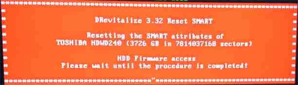

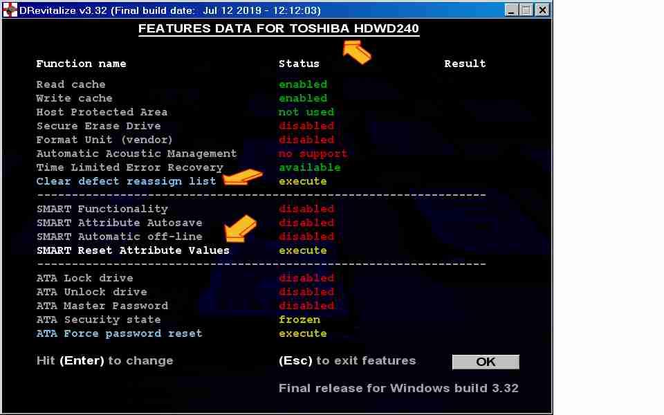

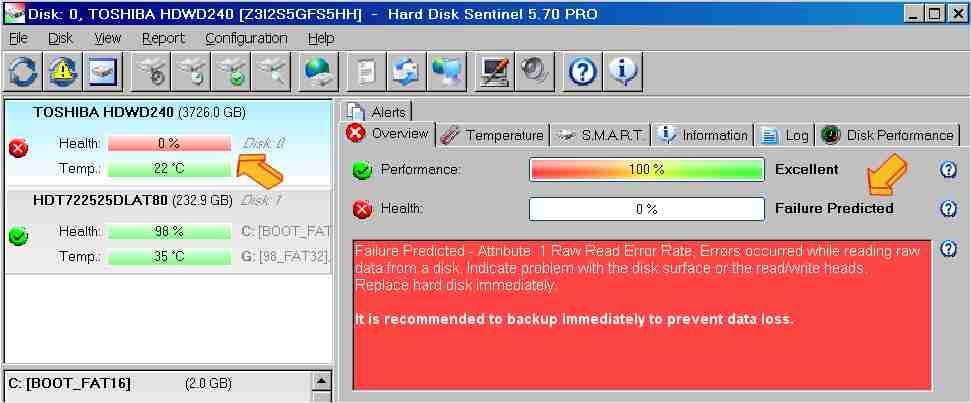

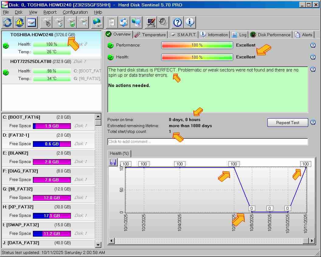

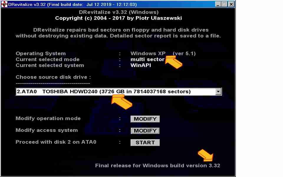

Experiment 2: How to reset the SMART values of a 4TB Toshiba HDD I was copying stuff under WinXP onto a Toshiba 4TB HDD in an external docking station. By mistake I pressed the wrong switch on the power strip and switched OFF the power supply of the external docking station, while the computer was writing to the 4TB HDD in it. After 3 seconds I noticed my mistake and switched the power supply ON again. WinXP on the desktop computer quickly froze and I had to pull the plug of the desktop computer. The activity light of the docking station with the 4TB HDD, however, kept on flashing (separate power supply), even after the desktop computer was powered off. I let the docking station flash for about 15 minutes, then powered off the docking station. I made several attempts to find out whether the 4TB Toshiba HDD was still OK 1) When I restarted the computer, with the 4TB HDD in the docking station, connected as before to onboard SATA, I got the BIOS message: "S.M.A.R.T Status Bad, Backup and Replace, Press F1 to Resume". 2) I then connected the external docking station to the ASM1061 SATA PCIe card set to IDE Mode. When booting I got the error msg by the ASM1061 card: Contact manufacturer. 3) I then booted the desktop computer with the Paragon Hard Disk Manager 15 and Acronis Disk Director 12.5 boot CDs (both Linux). The 4TB Toshiba HDD was NOT displayed anymore in their partitioning windows. BRICKED? 4) I then connected the external docking station with the 4TB HDD to the eSATA CardBus card in my old Inspiron 7500 laptop (Pentium III 650MHz, Phoenix BIOS of 1999, no detection of SMART values), and low and behold, the Acronis Disk Director 12.5 boot CD (Linux) displayed OK the 4TB HDD. I selected "Clean up" in the Acronis menu to set the 4TB to uninitialized. I then initialized, still with the Acronis boot CD, the 4TB HDD to GPT. My 25-year-old laptop can sometimes do more than a more recent desktop! The 4TB Toshiba HDD was displayed under WinXP by Hard Disk Sentinel as "BAD". The power failure while writing had also caused a reset of Power on time to "0 days 0 hours" and the Total start/stop count to 1. Hard Disk Sentinel has in its Information tab a Short Self-test and an Extended Self-test. I ran the Short Self-test, message after 2 minutes: HDD is OK, then ran the Extended Self-test, message after 3 minutes: HDD is OK. BUT: the health of the 4TB HDD was still displayed as 0%, with failure predicted. After these two OK tests I had my doubts about the "BAD" SMART status of the nearly new 4TB Toshiba HDD. I low-level formatted with my old Inspiron laptop under WinXP the 3626.0GB of the 4TB Toshiba HDD, with HDD Low Level Format Tool 4.50. LLFMT of this "BAD" 4TB HDD took 13:34:03 hours at 82.7MB/s, no error messages and the formatting time and speed were about the same as when I had low-level formatted the 4TB HDD fresh out of the box. Extended Self-test OK, LLFMT OK and at the same speed as when the 4TB HDD was new. The 4TB HDD seemed OK to me. I decided not to run with Hard Disk Sentinel the -> Disk -> Surface test -> Reinitialize disk surface on the 4TB HDD because this would have taken 5+ days. ["Overwrites the disk surface with special initialization pattern to restore the sectors to default (empty) status and reads back sector contents, to verify if they are accessible and consistent. Forces the analysis of any weak sectors and verifies any hidden problems and fixes them by reallocation of bad sectors (this is drive regeneration)."] For resetting SMART I used the selections "Clear defect reassign list" and "SMART Reset Attribute Values" of DRevitalize v3.32 (DOS version, 12Jul2019) on a FreeDOS boot floppy. The initial attempt briefly displayed "ERROR" in the Result column, after repeated attempts "SUCESS" was displayed, maybe several sub-HDDs are inside the 4TB Toshiba HDD and required multiple attempts, no idea. In any case the SMART values were reset, no more "BAD" flag. The "BAD" Raw Read Error Rate, Power on time, Total Start/Stop and other SMART values were reset. After having reset the SMART values I re-ran the Extended Self-test, which took nearly 8 hours instead of 3 minutes with the previous Extended Self-test. Message: Extended Self-test Successfully Completed. I have put a hand-written sticker "Self-refurbished OK" on the 4TB Toshiba HDD. DRevitalize v3.32 is a special build for WinXP, the preceding v3.31 and the subsequent versions require Windows Vista. The ability to handle Toshiba HDDs was added in this v3.32. DRevitalize v3.32 runs OK on a 4TB GPT HDD under WinXP with GPT Loader installed. The demo version 3.32 can be downloaded at https://drevitalize.com/current/Drevitalize332demo.exe Unfortunately the feature "SMART Reset Attribute Values" has been removed from the Windows demo version 3.32 and "license ordering is no longer available. Project is on hold" https://drevitalize.com/order/ The DOS version on the FreeDOS boot floppy, however, CAN reset the SMART values of a 4TB Toshiba GPT HDD, but is otherwise limited and cannot display the SMART values. DRevitalize v3.32 is of 12Jul2019 and still worked OK on the Toshiba 4TB GPT, manufactured in December 2023. DRevitalize v3.32 is a little jewel and has many other uses. Easy to use, highly recommended. Anybody here has experience with the non-demo Windows installer version of DRevitalize v3.32 ? - Today
