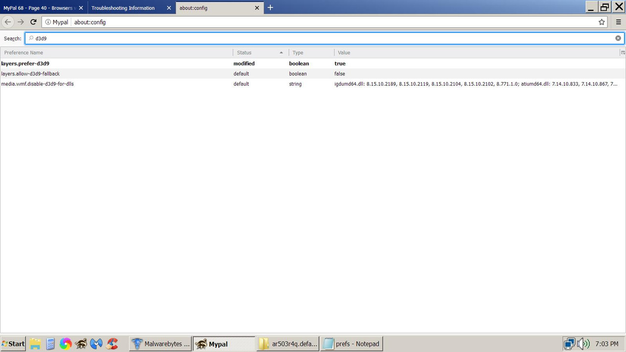

grey_rat Posted December 21, 2023 Posted December 21, 2023 On 17 Äåêàáðü 2023 ã. at 1:15 AM, UCyborg said: And another one could happen when forcing OpenGL compositing, which AFAIK Mozilla never intended to be used on Windows in the first place, but works in some browsers with glitches. Not exactly performant either, but with it, you can have video in a web browser without screen tearing, which I find to be an unusual phenomenon on Windows XP. I did notice at the later point D3D9 compositing works as well as with the old Firefox versions and roytam1's forks, just needs to be turned on manually in about:config. If you include layers.prefer-opengl in Mypal, V-sync will work. Test https://www.testufo.com/stutter#demo=smooth 1

XPerceniol Posted December 23, 2023 Posted December 23, 2023 On 11/29/2023 at 7:49 AM, grey_rat said: Firefox and MyPal catch d3d9.dll file but there is a conflict with hardware acceleration if it is enabled Does this look right to you, grey_rat? and I have hardware acceleration disabled on my old Dell 745. Thanks as you've always been helpful to me and I appreciate that.
