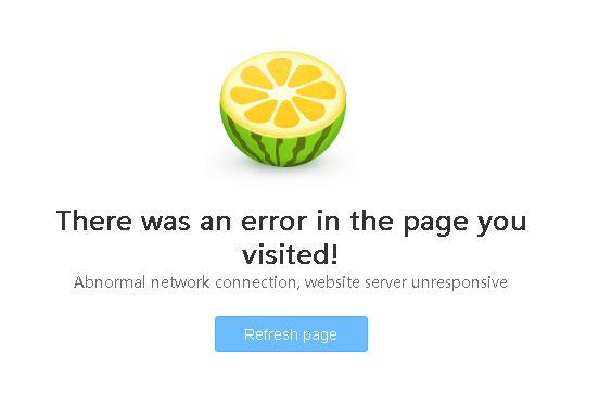

Anbima Posted September 16, 2022 Posted September 16, 2022 (edited) I have now installed V13 and V13.5 to test. With V13 I get on some pages the error message below. With V13.5 the page is displayed normally. What is the reason for this and how can I fix it? Is it possible to reduce memory consumption? Edited September 17, 2022 by Anbima
