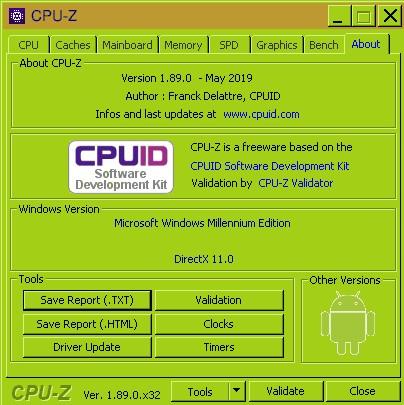

Goodmaneuver Posted July 24, 2019 Posted July 24, 2019 (edited) Notice anything different? Most parts of 9x service packs I would like to use like the VXDs for viewing/reporting up to 2TB of drive space on local and network drives and partitioning/formating without errors with Paragon etcetera. Remember XVDs are not interchangeable between Win98 and WinME. Edited July 27, 2019 by Goodmaneuver Looks like I have placed this in the wrong thread by accident it was supposed to be in kext-diy-kernelex-extensions
i430VX Posted July 26, 2019 Posted July 26, 2019 (edited) On 7/24/2019 at 11:53 AM, Goodmaneuver said: Notice anything different? Yeah, I don't see Windows Millennium Edition Reporting that it has DirectX 11 installed everyday! Edited July 26, 2019 by i430VX 1
FantasyAcquiesce Posted July 27, 2019 Posted July 27, 2019 On 7/24/2019 at 8:53 AM, Goodmaneuver said: Notice anything different? Most parts of 9x service packs I would like to use like the VXDs for viewing/reporting up to 2TB of drive space on local and network drives and partitioning/formating without errors with Paragon etcetera. Remember XVDs are not interchangeable between Win98 and WinME. Will DirectX 11 install on 9x!?
Goodmaneuver Posted July 27, 2019 Posted July 27, 2019 (edited) ~♥Aiko♥Chan♥~ I installed directx_Jun2010_redist several years ago, it updates files finishes but DX10 & 11 files do not transfer. Afterwards if the files are there and working then DX11 is reported by CPU-Z and DXdiag. The DX11 happened with KEX22 when going back to KEX18 then the reported DX vs is 9c. I have utilized some of ReactOS, I will report further. I do not know if it was fully functional though, see MSFN_Here for some of the idea. I will continue in the correct thread, my apologies. Edited July 27, 2019 by Goodmaneuver Improved 1
