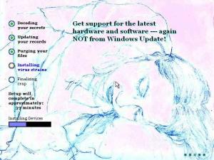

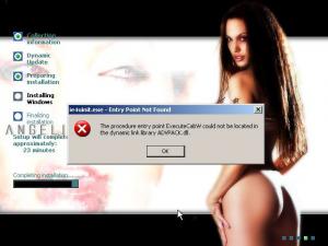

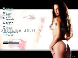

hi! i'd like to share mine ... in case this would be of any interest, i uploaded it HERE here's what they look like (i've posted 2 but only 1 for the winntbbu.dll & syssetup.dll --- the 2nd 1 ):

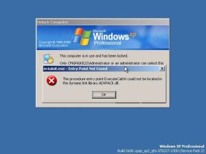

hi! prior to TC's post what i did was i took out roots cert from HF and proceeded w/ 931768 still in HF ... it slipstreamed ... i'll be using the latest test rel later to put everything back in ... hopefully, this nails it!

thanks for this Veranor ... it's truly odd since i had both root cert & 931768 in prev run & this error didn't come up ... oh btw, i forgot to mention in my prev post that as a result too, no IE7 was installed ...

hi TC & glentium! i got the same error too which happened at 2 different instances: strange since the other night i tried it but with some of the other ie7 supposedly superceded by 931768 still included (as identified here: Support for hotfixes not appearing on Windows Update) ... yet everything went well without this specific error ... it could be something else ... i've attached too HFSLIP.log from both runs ... i also tried to see integrated HFs by using Kel's Windows Update List CPL addon NirSoft's WinUpdate List & it shows nothing of 931768 ... attached the result too ... thanks! btw, as a result too, ie7 was not installed ... logs.7z
