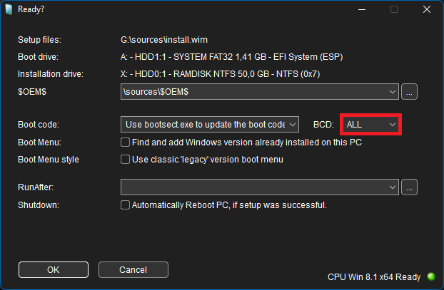

  9. Hi dimo70, if the selected boot partition is GPT, WinNTSetup automatically switch to UEFI only for bcdboot.exe. unless BCD option is set by ini or command line. This was requested years ago and actually makes sense. But if you use legacy boot with a GPT hybrid MBR, this causes promlems. Makes sure you set BCD option to "ALL".
    1 point

  22. Just guessing will not help much. WinNTSetup already uses these 2 commands. bcdboot.exe W:\Windows /s S: /f ALL bootsect.exe /nt60 S: /mbr Were W: is the Windows installation drive and S: is the selected boot partition. Only difference I see is the missing /force switch on bootsect command. But this is done on purpose, also diskpart does write bootable MBR and PBR. If you encounter the problem again try 1 of these command from a WinPE, to find out witch one makes a bootable again.

  24. That sounds like a problem with the MBR of the boot disk. By default WinNTSetup uses bootsect to update the boot sectors. bootsect.exe /nt60 S: /mbr The first 2 green lights are only using simple checks, there is no way to tell if the code is actually bootable. To limit the problem, it depends on what repair you do with bootice.
