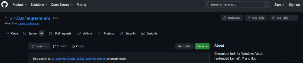

AstroSkipper Posted October 17, 2023 Posted October 17, 2023 (edited) 21 hours ago, VistaLover said: The red rectangle highlights the broken area in the new GitHub "header" ; this, I found, can be mitigated for now by blocking another set of "primer-primitives" GitHub CSS files, and I did that via a custom filter inside uBO-legacy: ||github.githubassets.com/assets/primer-primitives-$stylesheet,domain=github.com,important Result: Thanks for the fix! It works as described in Serpent 52, but unfortunately not in New Moon 28. Edited October 17, 2023 by AstroSkipper correction 3
VistaLover Posted October 17, 2023 Posted October 17, 2023 31 minutes ago, AstroSkipper said: but unfortunately not in New Moon 28. ... I beg to differ : then: 1

AstroSkipper Posted October 17, 2023 Posted October 17, 2023 10 hours ago, VistaLover said: 10 hours ago, AstroSkipper said: but unfortunately not in New Moon 28. ... I beg to differ : then: Sorry, my bad! I didn't notice that I had disabled uBlock Origin on GitHub in the past. Thus, the filter had no effect. After enabling, everything works as described by you. Thanks again! 3
