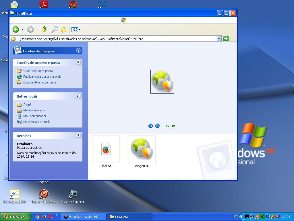

I wonder if you can help me. Few days ago I upgraded my avast to version 18.8.2356 from 18.6.2349 I felt compelled to do so since a critical vulnerability had been fixed in this version.. The day after I noticed that Behaviour Shield behaved erratically by turning off specially on start up. I did a repair but to no avail. Then I set aswbIDSAgent to automatic in services this worked for a day or two. Then I tried to do a clean install . During uninstallation right at the end Avast got stuck to : Deleting file C:\ documents and settings\all users\ application data\avast software\avast\html data\image 001.png  and winlogon was consuming almost 100% of cpu . After a forced reboot to my surprise avast had been removed from my computer.

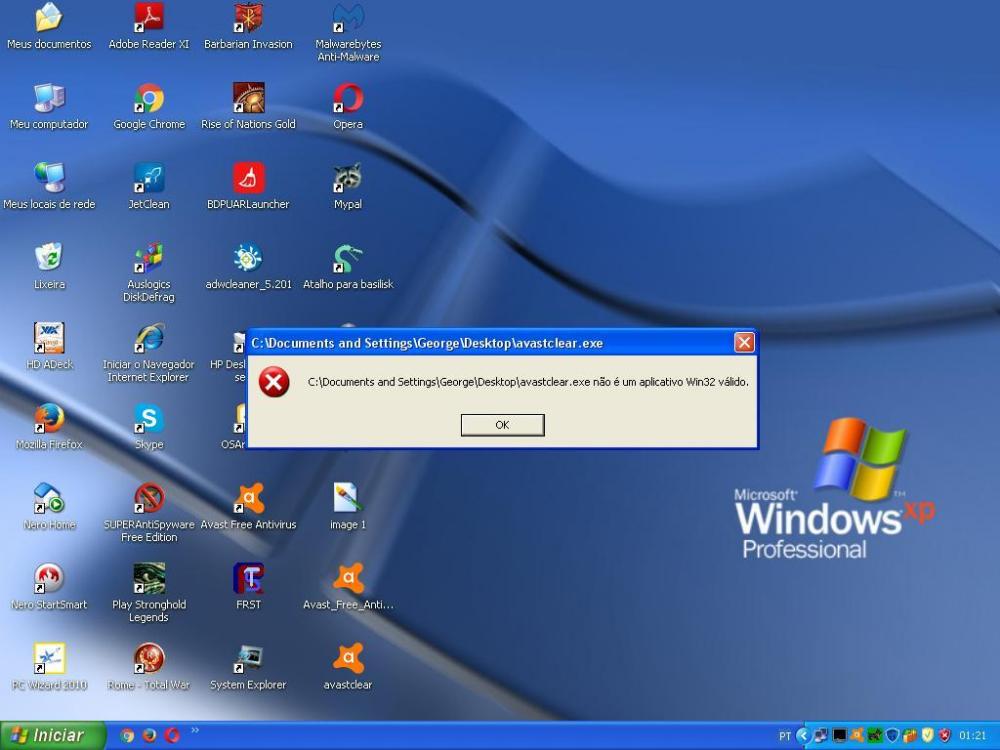

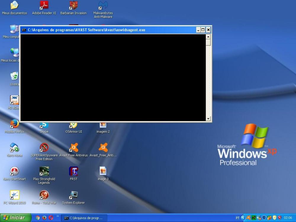

Could not use avastclear utility please see attached image 3. I installed avast but the symptom regarding B Shield persists. I did that quite a few times but the BS problem is still there. Also now when I start my computer Please see Image 1 of course as soon as everything is loaded it goes away. Once I set adwbIDSAgent to automatic and perform a repair BS turning off  occurs mostly at start up. Once I turn it on manually it stays on till the end of the day well not always. If I turn on BS from protection menu instead of main GUI never turns off. Same thing happens when I try to uninstal in safe mode.
I was considering the idea to delete html data from application data folder then use revo and do a thorough uninstall of avast or uninstall it from add/remove forced reboot and then delete avast application data folder and then install again. I found an off line installer of the version I was using but there is no way to install it due to winlogon high cpu consumption. I guess you can't use off line installers for winxp.

It seems this is the main culprit,tried to delete htmldata got a message saying access denied, blocked html cannot be removed  :huh:
Ok problem solved. How ? please do not ask is beyond me. The only thing I still get that blank thing depicted in image 2
but as soon as avast is fully loaded it goes with the wind. :thumbup
