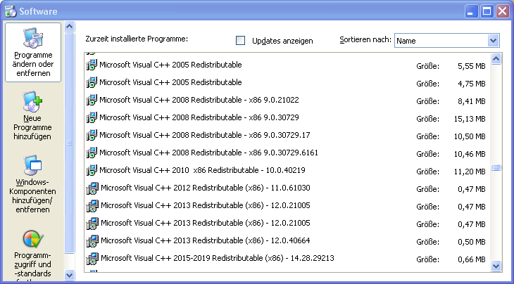

5 hours ago, NotHereToPlayGames said:
Ok. Microsoft Visual C++ 2015 Redistributable was installed in your system. Very good! Without it, you also couldn't have tested my program package, though. :no: And, unfortunately, you are not up to date. As @mina7601 already posted, the latest version is 14.28.29213update.gif Your version is 14.0.24215. Have a look at my screenshot! nonono.gif

12 hours ago, AstroSkipper said:
Thanks @mina7601 for your addition! I just wrote Microsoft Visual C++ 2015 Redistributable because that was the information I got from @cmalex. In my system, I already installed Microsoft Visual C++ 2015-2019 Redistributable, therefore I did not need to install a further version of Microsoft Visual C++. But the more recent the more better, at least for essential system files. :)
You're welcome! And I know, I was actually requesting a change just for accuracy.
