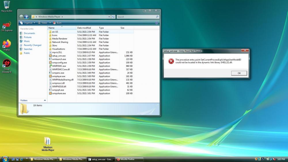

Jakob99 Posted May 12, 2021 Posted May 12, 2021 I tried to run Windows Media Player 12 (extracted from Program Files from a Windows 7 installation I am using) and got this error to pop up after running setup_wm.exe: The procedure entry point SetCurrentProcessExplicitAppUserModelID could not be located in the dynamic link library SHELL32.dll. And I did open each exe file in CFF Explorer and changed all three instances of 6.1 to 6.0. After closing the error box, it then tells me that Media Player has stopped working.
