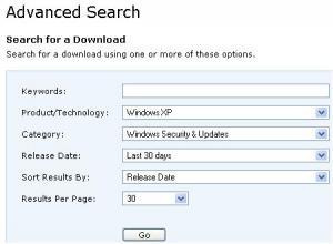

thanks S3pHiroTh! this confused me for KB928470: & i didn't read this thoroughly: ... did what i usually do via Advanced Search

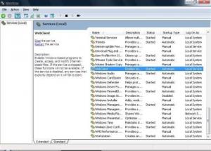

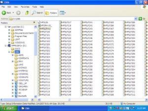

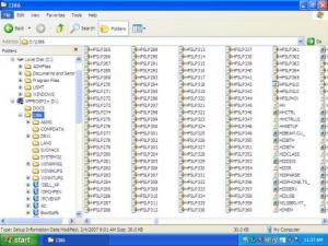

No... Are the files physically present on the CD from which you installed your HFSLIPped copy of Windows? Open the CD, go in the I386 folder and see if hfslp101.inf through hfslp103.inf are in it.hi TC! became much worse this time ... still the same prompts for hfslp101.inf until hfslip103.inf ... then it continued on from hfslp200.inf until hfslp365.inf ... presumably all hfslp###.infs ... i've attached some files that might be useful from this run) ... checking i386 folders though in the cd shows all hfslp###.infs present Seems OK. For DNF30.exe, you should've seen the installation dialogs pass by (Windows Presentation Foundation, Windows Communication Foundation and Windows Workflow Foundation). If you've seen these, was that at T-13 or at first GUI logon?these all came up after window to register ...
hi! if this is a Dell, changing mobo requires activation ...

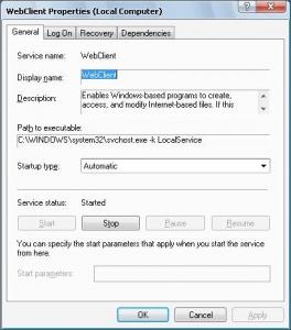

yup ... it's just a theme in the background ... i'm simply showing here some details about web client svc that might help clarify some issues
I mean: are HFSLP101~103.INF still present on the CD from which you install?hi TC! if i understood this correctly ... as SOURCESS was technically my ISO, yes this prompt (+ 101.inf & 102.inf) came up during install ... Well... If you have DNF30.EXE in HFGUIRUNONCE, you can easily find out if something went wrong by checking if the WebClient Service is working properly: Control Panel > Administrative Tools > Services. Based on my testing, the WebClient service will fail to start if .NET 3.0 is installed at T-13.attached are some screenshots ... thanks!
