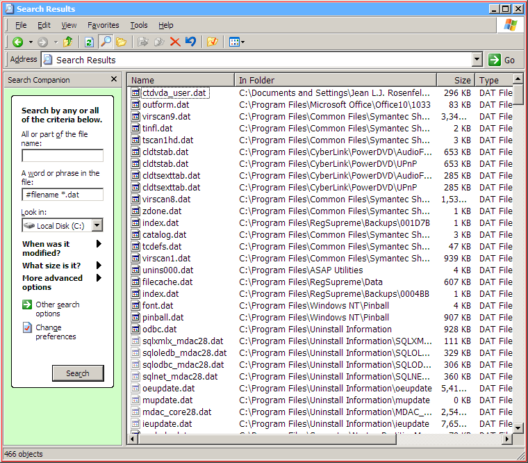

  24. In XP with indexing service on, using indexing search query language is almost instantaneous:
