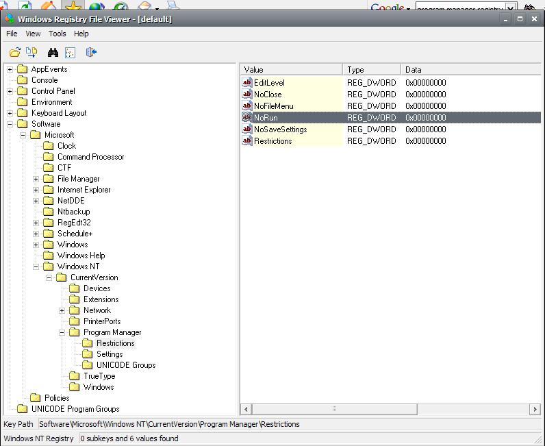

  7. I am not really concerned with that issue because I found a program that allows me to do it outside ERD/WinPE. Now my issue is back to where are the start menu items listed....
  8. Nope no dice but I did get inside it, still nothig though, I am assuming it is because I am uber the assumption that it used MS explorer when it actually uses it's own version filexplorer. But I did get some useful info seems like it uses proram manager registery entries to control certain aspects, i.e. NoRun, NoFileMenu, NoClose, etc.

  17. Seems to me that ERD encrypts the registery files after the ISO is created, due to not being able to load them into a registry editor, I have looked at them while creating the files for the ISO and they are mainly the normal REG files for WinPE, but the file sizes after the ISO is built is considerabley smaller in the defalt.hiv file. Anyhow anyone got any ideas?

  21. If it was only as easy as choosing the winner..... Go Nordiques! oh wait... I mean Go Av's!
