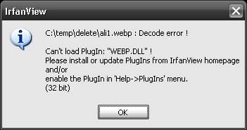

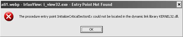

WEBP would also be nice... Didn't WEBP work before in Irfanview on XP? Anyway, attached are the errors with the latest WEBP.DLL plugin (4.57.0.0).
