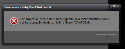

The site is still blocked on the DNS level in some countries like Canada. Obtained the latest 132 copy from Github. Now I get this.

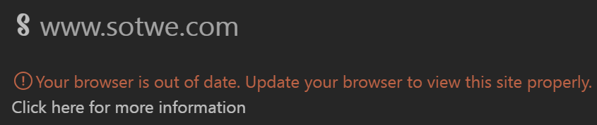

Yes; the page could've been clearer on exactly how "modern" your browser's Javascript needed to be. At any rate, UXP does seem up to the task, albeit inefficiently. There are many reasons that might have caused me to get the "denied" page, but it wasn't worth the effort to track it down. I was just wondering what kind of nonsense we WWW users have to deal with now, and why. My curiosity is "mostly" satisfied now. -
