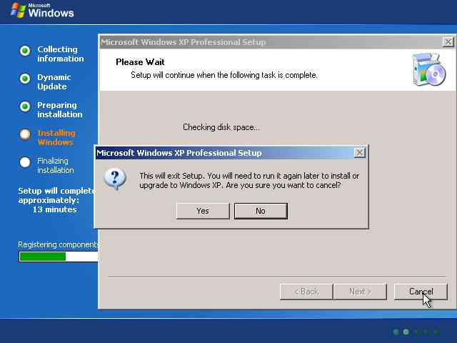

(1) RC installation gets stuck while on Checking for disk space status ... the only option is too cancel its installation for silent installers to push through with the installation at T-13 ... as expected, RC is no longer an option on boot ... just wondering if there'd be some modifications in the code ...

(1) RC installation at T-13 still halts when Checking for diskspace ... no other option but to cancel it ... thus RC is not an option upon boot

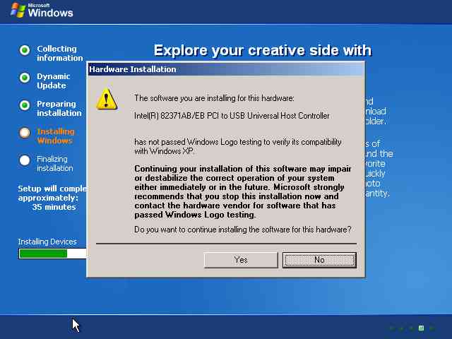

(2) how do we get rid of prompts like: "The software you are installing for this hardware ... has not passed Windows Logo testing to verify its compatibility with Windows XP" usually at T-35 to T-34 ... this happens for about 5 or more times?

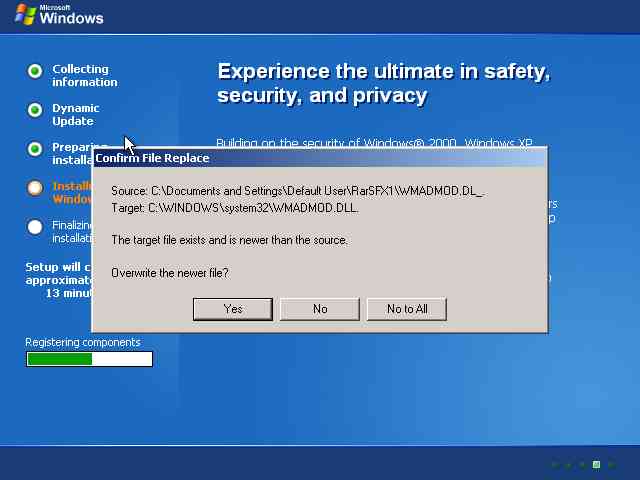

(3) been getting Confirm File Replace prompts too for the following files: qasf.dl_, wmamod.dl_, wmsdmod.dl_, wmspdmod.dl_, wmvdmod.dl_

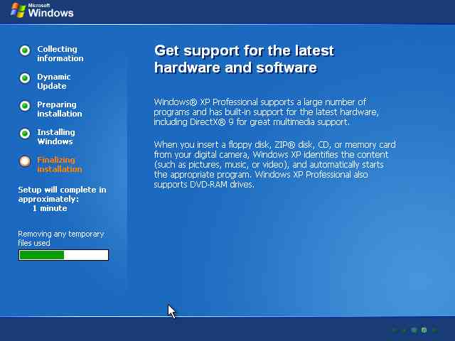

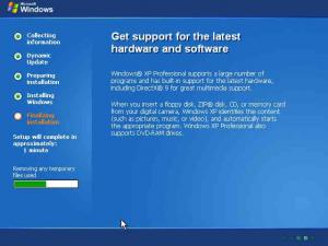

(4) being stuck at 1 minute to go while Removing any temporary files used ... waited for this for so long (this happened 2x) & no option but to restart setup ...

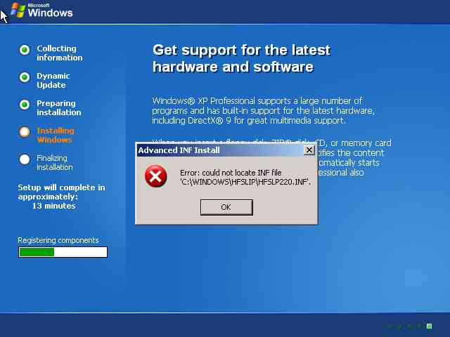

(5) restarting setup proceeds normally but this time new issues come up --- Advanced INF Install nags: Error: could not locate INF file `C:\WINDOWS\HFSLIP\HFSLP220.INF' ... this begins with HFSLP220.INF to HFSLP365.INF (quite a lot :) ) ... then proceeds to being stuck at 1 minute again ...
