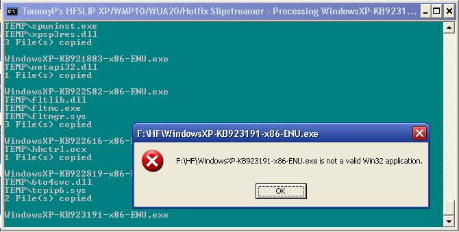

hi! finally i was able to run some tests on ver 61012a over the weekend (although a bit late as there is now a newer ver 61014c ;) ) (& not my pc yet as i need to purchase new cpu & mobo :( ) ... attached are the usual files for review ... attached too are some screenshots ... thanks!
about 923191 pic, after clicking OK, the following lines show:
WindowsXP-KB923191-x86-ENU.exe
Access is denied.
The system cannot find the file specified.
0 File(s) copied
i'm redownloading the file to see if perhaps my file is corrupted ...
taking it out of HF directory does not show the error ...

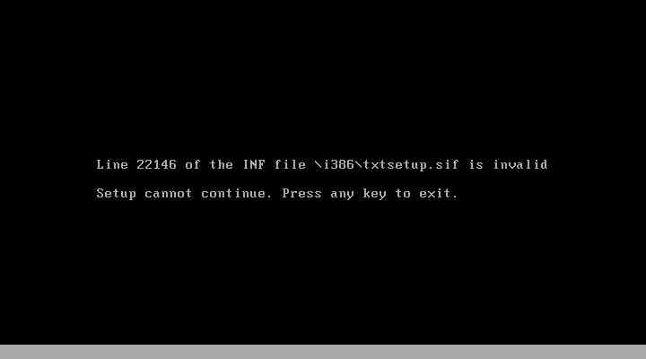

btw, the line errors in txtsetup.sif changes ...

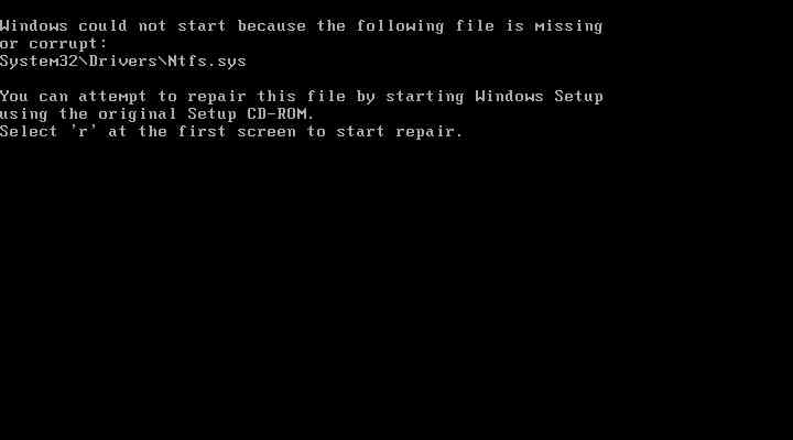

also, i don't understand why my ntfs.sys becomes corrupted :(
