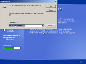

@TC:
Here is a screenshot of the popup..
Oh yeah, it does look like 61017a & 61017b broke an application that I install after the final reboot, "IBM System Update".
NtegrA...
Strange. "wmlaunch.exe" is part of MP10Setup.exe. Are you removing it with nLite or something?
