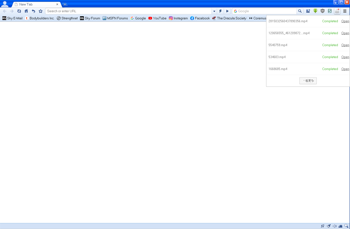

Dave-H Posted April 13, 2022 Posted April 13, 2022 Another bit of residual Chinese I keep meaning to mention and forgetting!
NotHereToPlayGames Posted April 13, 2022 Author Posted April 13, 2022 Do you know the "function" that button performs? Is it just an "OK" that all downloads are completed or does it open the "Download Manager"?
Dave-H Posted April 13, 2022 Posted April 13, 2022 It opens the Download Manager. It only appears when there's several entries in the list (perhaps more than six?) so it could be an "All" button, maybe that is the most that can be displayed there. I can do some tests on that if you like.
Dave-H Posted April 14, 2022 Posted April 14, 2022 Just to update, it seems that a maximum of five entries are shown in the downloads menu. After that, only the most recent five are shown, and the button with Chinese on it appears. I guess that's so you can go to the Download Manager and see the downloads which are no longer displayed. I would thank that 'All' would probably be the right labelling for the button in that case.

NotHereToPlayGames Posted April 14, 2022 Author Posted April 14, 2022 3 hours ago, NotHereToPlayGames said: domain ws-in-f188.1e100.net I have been unable to replicate this on five different computers. Unless another v13.5 user can report this also, I kinda have to assume this is only on your system. 15 hours ago, Dave-H said: After that, only the most recent five are shown, and the button with Chinese on it appears. I cannot find this and the Chinese also appears in the Russian Repack, suggesting they could not isolate this button either. With it only being an on-hover and only being when six or more downloads are downloading, seems too much or a rarity to worry too much about. I'll keep digging for curiosity, but it's not looking like it's going to be in any of the normally-modified files.
Dave-H Posted April 14, 2022 Posted April 14, 2022 OK, no problem with either issue as far as I'm concerned, they don't affect the usability of the browser at all. I guess the first tab may not be trying to connect to anything at all, I've looked quite a few times and while the browser always seems to have a connection or two going, there is no consistency in fact as to what addresses it's accessing. It could just be that the loading of the first tab can't complete for some other reason. As for the Chinese button, interesting that the Russians didn't translate that either, I guess as you say its label is a bit buried somewhere! It's the only bit of Chinese I've spotted in the GUI, so you've done a pretty thorough job everywhere else!
