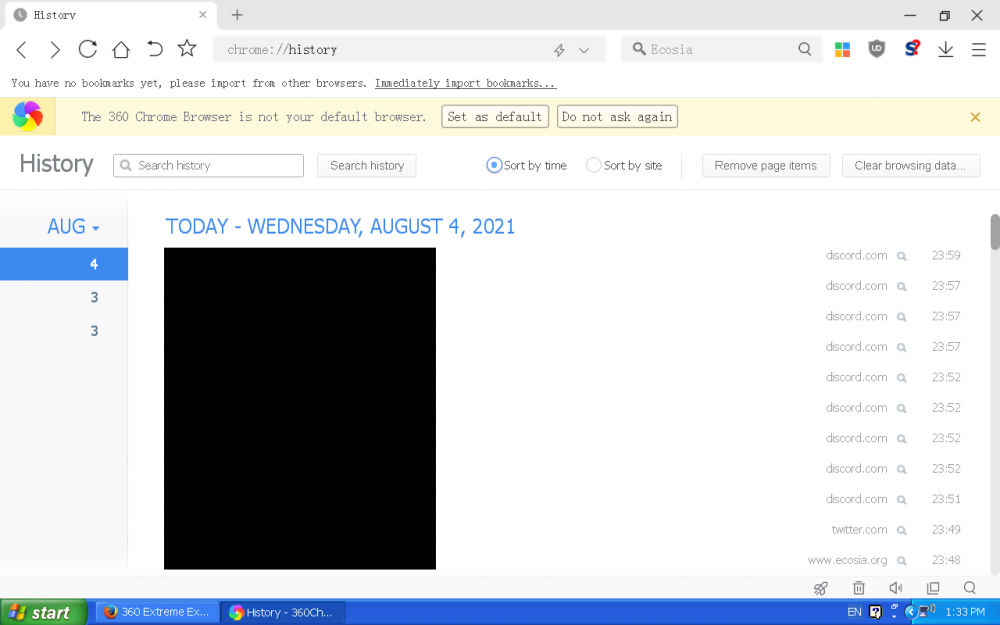

In the process, though, I remembered another weird thing I've been facing. 360chrome seems to only save my browser history *sometimes*. After trying to look at my history for the past hour (I had visited my college website and was going to clear my history/cookies), I found that none of the pages I visited were present. In fact, 360chrome still seemed to believe that today is Wednesday, August 4.  The last entry was at 23:59 on Aug 4, with none of the pages I visited today around midnight. It also has two entries for Aug 3 that both contain the exact same contents. When checking Aug 3, I also noticed that my last entry (Google at 23:43) had the same icon as the university website until I ran a "Clear browsing history" for the past hour and restarted the browser.
Edited by beansmuggler
forgot to add picture
I do know that the "anti-tracking" feature (which I do not use) is offset by 24hrs and I have fixed this in my release and pointed it out to Humming Owl for his release.
Aside from that, my "history" page is off by ONE HOUR but the month/day/year is correct.
Had'nt noticed that ONE HOUR difference until just now.
