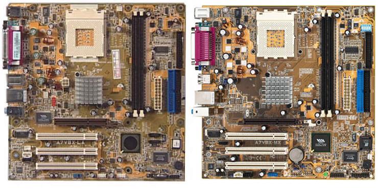

Well, it might. From what I can see, the main difference between the HP board (A7V8X-LA) and the mainstream A7V8X-MX is that the MX uses a 8235 southbridge, while the LA uses a later 8237 southbridge, which is actually better (supports DDR 400 and SATA). On the other hand, that's SATA I (= SATA 150) only, SATA II HDDs will work only if jumpered down. Today's SATA III are a no-no, since they can only be jumpered down to SATA II speeds, if at all. And as for the FSB, while the 8237 can work at 400, that particular mobo cannot (here is the manual). That means that it really can use an Athlon XP 3200+, but you'd have to hunt for an AXDA3200DKV4D, which is very rare and works at 333 MHz, not the common garden variety, AXDA3200DKV4E, findable everywhere (well... sort of...).
post-134642-0-68444100-1318572104_thumb.
Den, you're reading the wrong manual. The Kamet is the older HP Pavilion variant of this motherboard. I run the Kelut. The FSB is 266-400 MHz. So that would mean this motherboard can run the AXDA3200DKV4E or 4D, 1.65 V CPU with no tweaking, right?
