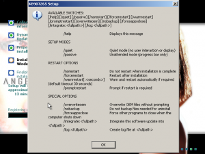

  10. hi johndoe! pardon me for asking ... but how do i repackage HF like 907265? kindly guide me on this one ... you see, after reading that it could already be supported, i tried putting it back to HF & result was this in HFSLIP.log:Files in your HFSVCPACK_SW2 folder: WindowsXP-KB907265-x86-ENU.exe ... prompt came up during installation showing switches ... thanks in afavance! kiki you don't need to repack it anymore with the latest builds of hfslip. what you're doing wrong is putting it in the SW2 folder. that folder is only for the hotfixes that use /Q:A /R:N switches for silent install without reboot. if you put it in SW1 (for hotfixes that use /quiet /norestart switches to install), it'll work just fine!thanks johndoe what i did initially was let HFSLIP take care of it by placing it in HF ... as a result, it was placed in SW2 dir instead of SW1 ... i'll do just that then manually ...

  12. hi johndoe! pardon me for asking ... but how do i repackage HF like 907265? kindly guide me on this one ... you see, after reading that it could already be supported, i tried putting it back to HF & result was this in HFSLIP.log:Files in your HFSVCPACK_SW2 folder: WindowsXP-KB907265-x86-ENU.exe ... prompt came up during installation showing switches ... thanks in afavance!

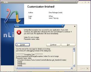

  24. Kiki Burgh posted a topic in nLite
    hi nuhi! i got the following errors in my latest attempt ... although i've used 1.3.5 in some previous runs & i didn't get these ... i just thought it would be worth looking at: ... i got this when i clicked on back (since i accidentally skipped the building iso portion) ... below too is the entire text of the details: See the end of this message for details on invoking just-in-time (JIT) debugging instead of this dialog box. ************** Exception Text ************** System.ArgumentOutOfRangeException: Index 0 is out of range. Parameter name: index at System.Windows.Forms.Control.ControlCollection.get_Item(Int32 index) at .. () at .. (Int32 ) at ..() at ..(Object , EventArgs ) at System.Windows.Forms.Control.OnClick(EventArgs e) at System.Windows.Forms.Button.OnClick(EventArgs e) at System.Windows.Forms.Button.OnMouseUp(MouseEventArgs mevent) at System.Windows.Forms.Control.WmMouseUp(Message& m, MouseButtons button, Int32 clicks) at System.Windows.Forms.Control.WndProc(Message& m) at System.Windows.Forms.ButtonBase.WndProc(Message& m) at System.Windows.Forms.Button.WndProc(Message& m) at System.Windows.Forms.Control.ControlNativeWindow.OnMessage(Message& m) at System.Windows.Forms.Control.ControlNativeWindow.WndProc(Message& m) at System.Windows.Forms.NativeWindow.Callback(IntPtr hWnd, Int32 msg, IntPtr wparam, IntPtr lparam) ************** Loaded Assemblies ************** mscorlib Assembly Version: 2.0.0.0 Win32 Version: 2.0.50727.42 (RTM.050727-4200) CodeBase: file:///C:/WINDOWS/Microsoft.NET/Framework/v2.0.50727/mscorlib.dll ---------------------------------------- nLite Assembly Version: 1.3.5.0 Win32 Version: 1.3.5.0 CodeBase: file:///C:/Program%20Files/nLite/nLite.exe ---------------------------------------- System Assembly Version: 2.0.0.0 Win32 Version: 2.0.50727.42 (RTM.050727-4200) CodeBase: file:///C:/WINDOWS/assembly/GAC_MSIL/System/2.0.0.0__b77a5c561934e089/System.dll ---------------------------------------- nLite Assembly Version: 1.3.5.0 Win32 Version: 1.3.5.0 CodeBase: file:///C:/Program%20Files/nLite/nLite.exe ---------------------------------------- System.Windows.Forms Assembly Version: 2.0.0.0 Win32 Version: 2.0.50727.42 (RTM.050727-4200) CodeBase: file:///C:/WINDOWS/assembly/GAC_MSIL/System.Windows.Forms/2.0.0.0__b77a5c561934e089/System.Windows.Forms.dll ---------------------------------------- System.Drawing Assembly Version: 2.0.0.0 Win32 Version: 2.0.50727.42 (RTM.050727-4200) CodeBase: file:///C:/WINDOWS/assembly/GAC_MSIL/System.Drawing/2.0.0.0__b03f5f7f11d50a3a/System.Drawing.dll ---------------------------------------- ncab Assembly Version: 0.0.0.0 Win32 Version: 1, 0, 0, 3 CodeBase: file:///C:/Program%20Files/nLite/ncab.DLL ---------------------------------------- msvcm80 Assembly Version: 8.0.50727.762 Win32 Version: 8.00.50727.762 CodeBase: file:///C:/WINDOWS/WinSxS/x86_Microsoft.VC80.CRT_1fc8b3b9a1e18e3b_8.0.50727.762_x-ww_6b128700/msvcm80.dll ---------------------------------------- nlgw Assembly Version: 1.1.0.0 Win32 Version: 1.3.5.0 CodeBase: file:///C:/Program%20Files/nLite/nLite.exe ---------------------------------------- MCDBNET2 Assembly Version: 1.32.0.0 Win32 Version: 1.32.0.1302 CodeBase: file:///C:/Program%20Files/nLite/MCDBNET2.DLL ---------------------------------------- Accessibility Assembly Version: 2.0.0.0 Win32 Version: 2.0.50727.42 (RTM.050727-4200) CodeBase: file:///C:/WINDOWS/assembly/GAC_MSIL/Accessibility/2.0.0.0__b03f5f7f11d50a3a/Accessibility.dll ---------------------------------------- ************** JIT Debugging ************** To enable just-in-time (JIT) debugging, the .config file for this application or computer (machine.config) must have the jitDebugging value set in the system.windows.forms section. The application must also be compiled with debugging enabled. For example: <configuration> <system.windows.forms jitDebugging="true" /> </configuration> When JIT debugging is enabled, any unhandled exception will be sent to the JIT debugger registered on the computer rather than be handled by this dialog box. ... in some other runs, i got these too: could nLite have deleted the files? ... i've attached my last session.ini (i have w/ me some other files: dosnet.inf, drvindex.inf, sysoc.in_ & txtsetup.sif that might shed light to this if required) too for reference purposes ... i'd like to mention too that my run this time was sluggish as compard to the previous runs ... it took time extracting files & also the step prior to finalizing ... i've tried to uninstall & reinstall nLite but still the same results (regarding the slow-down) ... thanks! Last_Session.ini
