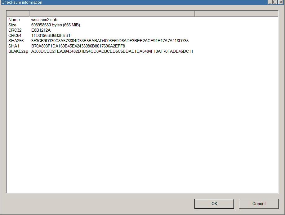

  5. My WinXP is UK. Windows Update Agent files are version 7.6.7600.256, except wuweb.dll which is at 7.6.7600.257. As per Md5Checker 3.3, the MD5 for the downloaded wsusscn2_sha1.cab (July 2020) is a match. The December 2019 wsusscn2.cab (WBM link provided by max-h), on the other hand, does work with WUMT. Its MD5 appears to be BE65CE3E77B7EF1EFDEB112A95495607.
    1 point
  6. ----------------------------------------------------------------------------------------------------------------------------------------------------------------- Sorry for the quote spam. I just want to point out that those are file hashes listed in both of these recent posts, which is NOT the same thing as Microsoft's SHA1 signing key. These are just useful for checking for file integrity after a download to ensure that the downloaded file is identical to the original.
