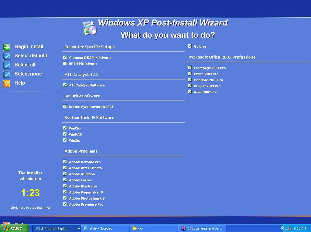

hasi001
thanks for the extra line info i didnt knw <p> was the code i needed thanks! it worked fine with just adding the line (see screnshot to see what i meant)
QUOTE
2. You know the window that shows up after you execute the script and it goes through each program installing one by one???? Is there a way to turn that into separate windows??? Ie each category has 3 programs in it.... and when it installs the 1st window pops up...
Edit generate.js, line 190 says
CODE
if (j==15) // call RunOnceEx every 15 apps, so that the window doesn't grow too big
Change 15 to 1 and every app installs seperately.
thats cool but what i want to do is have a new window for each category of prgrams.......
ie if u select all of the adobe programs..... those would show up under a window titled 'adobe software" it would install all of those then move onto the next category "ms office 2003" install those comonents etc.....
first is there a way to title the windows????
second how can we put only categories into those windows?
