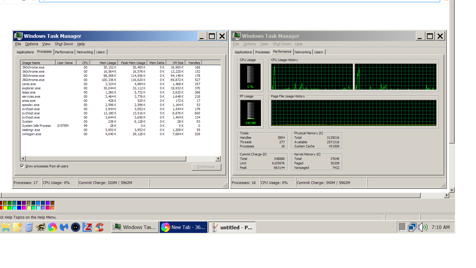

Now I just went into the BIOS and disabled the two HyperThreading cores. Run the test again: Taskmanager shows now 2 threads instead of 4, and the 360chrome memory allocation is quite the same (=low) so I did not bother to make a screen shot again.
I'm still starting to think it's not Hyper-Threading.  Maybe graphics-related?

What software do you like me to use to test to values on my computer? I keep seeing it but don't know.
Anyway. opening a black window from first run and doing nothing.
Edited by XPerceniol

Hi, its me, the one you love to hate (or is it ... hate to love)  ... haha
Again, what software are you guys using so I can test and help out, please.
Thank you.
