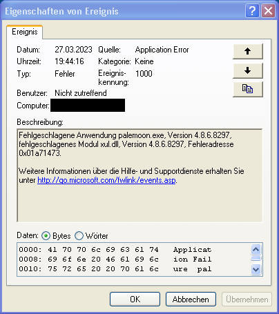

I have been running last Saturday's St52 (32-bit) build (BuildID=20230324153850) for a whole 3 days now and can confirm that the "xul.dll" crashes I first spoke of here no longer happen :thumbup; so it was indeed Bugzilla #1440809 (landing first on Fx60) that had to be applied to "our" UXP tree to get those crashes fixed... Many thanks :wub: (FWIW, don't "upstream" also need this fix, or is it specifically tied to WebExtensions ? :dubbio:).
Speaking of "xul.dll" crashes, another type of them (see #2176) was addressed by upstream in PR #2178, that fix has already been transferred to "our' tree and will be included in the next UXP-based releases (Sat, Apr 1st 2023) ;) .
I also had a few crashes of xul.dll today, in the most recent release of New Moon 28 (2023-03-24), though. Here are two screenshots of these events:
