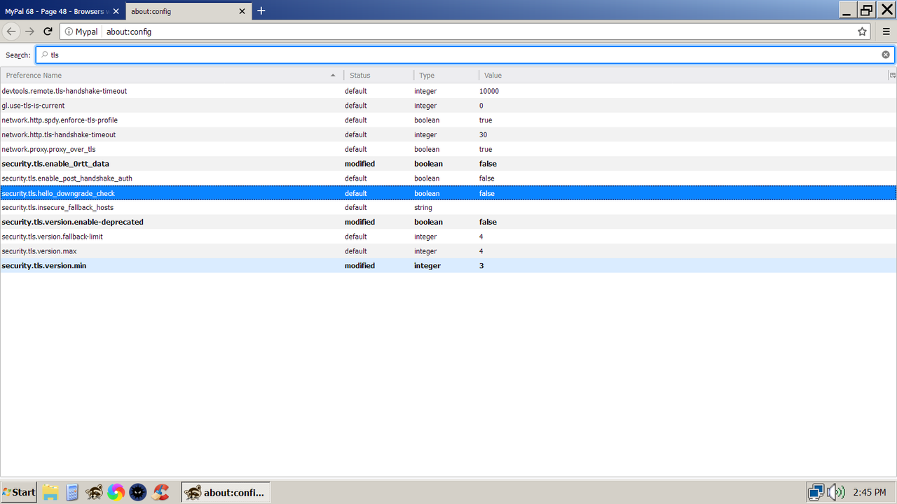

XPerceniol Posted March 19, 2024 Posted March 19, 2024 (edited) https://www.cloudflare.com/ssl/encrypted-sni/ Hi everyone! 2 Questions here regarding "Secure DNS" and "Secure SNI (hello)" 1. Is there a setting I'm missing because even though I am using CF (1.1.1.1) I can't any longer get a secure connection on Mypal68 which means anybody listening on the wire can see the DNS queries I made - I could have sworn that at one time a while (perhaps 3b as I'm now using 9b) back then I was getting a secure connection to 1.1.1.1 but not now, as you can see. Please also see pictures on the next posting regarding Secure DNS. Regarding SECURE SNI (hello) which means anybody listening on the wire can tell which sites I made a tls connection to. @grey_rat ... do you by any chance know what I'm asking or @feodor2? I Have that only hello pref set false (default). (security.tls.hello_downgrade_check;false) network.dns.echconfig.enabled network.dns.http3_echconfig.enabled network.dns.echconfig.fallback_to_origin_when_all_failed security.tls.ech.grease_probability security.tls.ech.grease_size security.tls.ech.grease_http3 security.tls.ech.disable_grease_on_fallback network.dns.force_waiting_https_rr These are not available. Should I add manually? Thanks for any advice. Sal PS: Sorry about the multiple edits ... I'm struggling pretty badly today, so I'm sorry if I make little sense. I know I goofed up my postings a little. Again, sorry. Edited March 19, 2024 by XPerceniol
XPerceniol Posted March 19, 2024 Posted March 19, 2024 (edited) 2. These are my only settings for DNS that I use on mypal68. I mean to put this under the last posting - I use 1.1.1.1 and 1.0.0.1 on my router and in the XP connection network settings. Edited March 19, 2024 by XPerceniol
