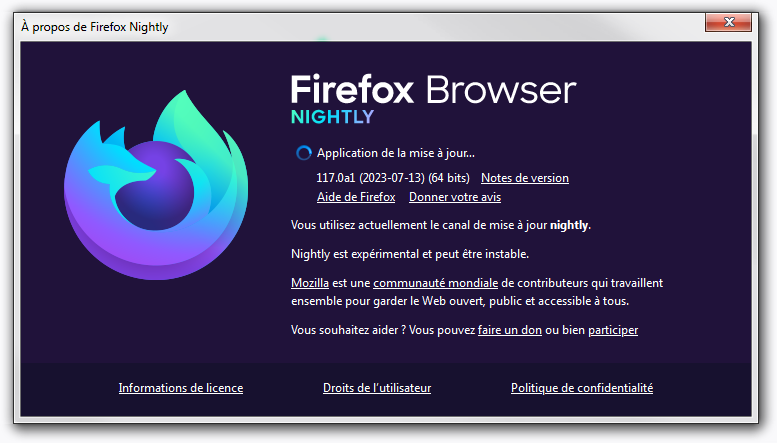

  5. Hi, am I the only one to have my FxNightly install got automatically updated to a newer build despite it shouldn't be possible? I mean, I kept my FxN on the v117 July 18 build (as I still use it for some things), and when I wanted to open the browser this morning I noticed it self-updated to a v119 build (2023-09-06) (which obviously doesn't run due to missing DLL entries). So I manually downgraded my install to the July 13 build, and as soon I restarted, the browser immediately started to download and install a newer build (2023-09-12), definitely proving the update ability is not blocked anymore... I put the policy file to completely block updates but now I'm wondering why (and especially how) it happened, as it never behaved like this during the two past months (It just showed the orange triangle like on my FxDE install) (Maybe it happened because it was a v117 build and not a v115 one. Or there's something else I didn't understand yet)

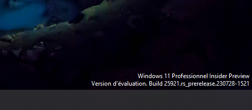

  7. The latest Canary build completely broke the system tray. I suspect the fact the latest build (25921) cleared some things from explorer.exe so I think MS is probably going to remove the old taskbar completely in the next builds.

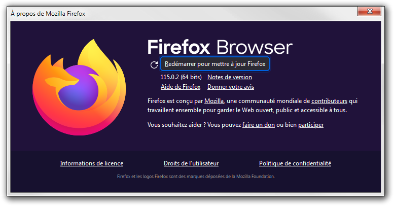

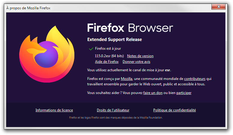

  9. UPDATE ! Mozilla pushed an update this afternoon, and it was for the move to ESR.
  10. For the moment, the only thing to modify in order to make Firefox runnable again is the required subsystem version strings, which can be done using a tool like CFF Explorer. This is also a sign they will probably start to implement Win10+ functions into the browser. I also tested with the VxKex version spoofer and it doesn't work, so if you really need to run newer builds of Firefox, you will need to modify the binary by yourself.

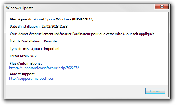

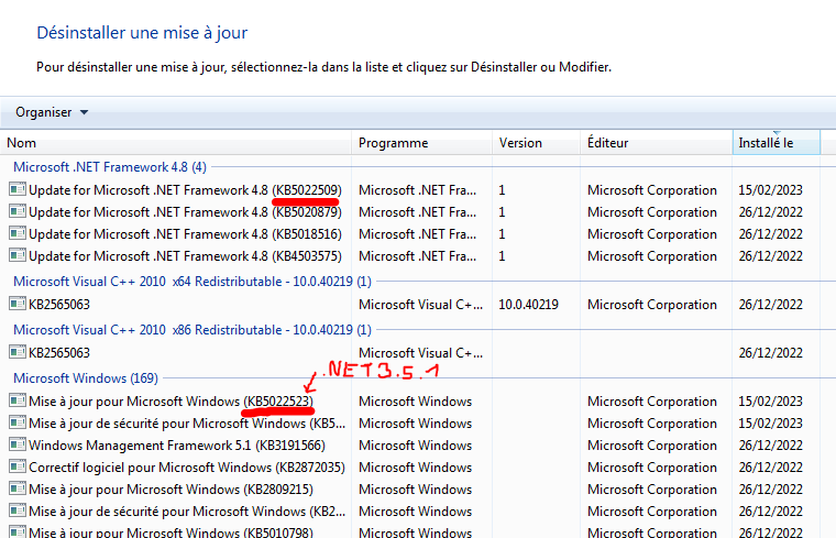

  12. I installed updates on my W7, seems to be okay after 1.5 hour. .NET updates also installed successfully.
