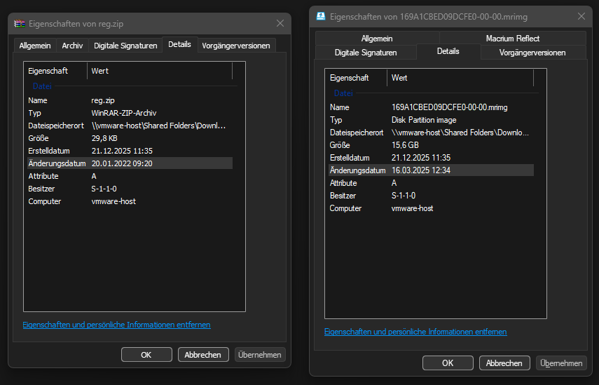

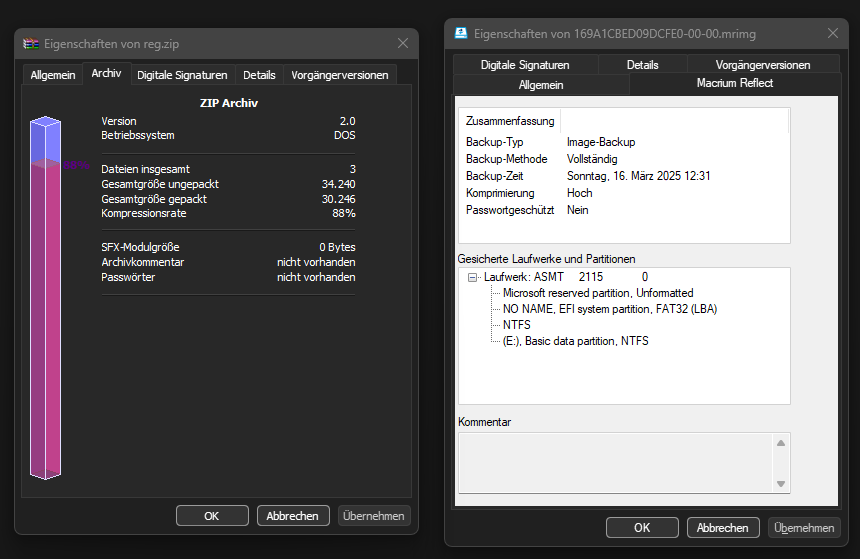

Details is in dark mode, it is a native tab from Explorer. "Archiv" is a custom tab from WinRAR and Macrium Reflect is a custom tab from well Macrium Reflect. Here it is compared to the very old WinRAR 5.31, to show that it is properly colored with dark magic. And here is the “Details” tab for reference. It functions as expected. Unfortunately, I'm not aware of many programs that have a custom tab to test this further.

Both are, indeed, but one seems a custom object. The other tabs on the Macrium file are not with dark mode ? Like "details" for example.
But both are, or am I mistaken? Also I am not using the WinRAR Update with dark mode yet.

Because that is a file explorer properties window. Also, WinRAR has integrated dark theme, if that makes any difference.

I guess it's because it's a custom object, not a native one. For this you'd need a theme, that enforces dark colors (like Rectify11 dark theme).
