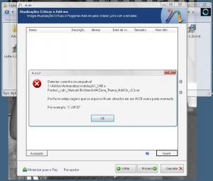

I do not get this error in old nLite versions. Only in nLite 1.2.1.
It is a minor problem, what I can workaround changing the names in path, but it is a bug.
May be the add on you want to integrate is not nLite compatible? or try to use a fresh files of XPCD
No, the addon is ok. It is a Ricktendo64 addon and I use in 1.2RC or 1.0.1 without problem.
