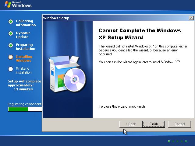

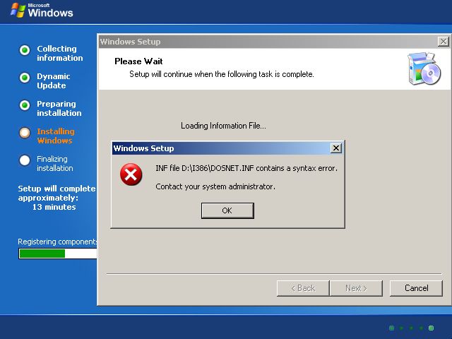

Kiki Burgh Posted June 22, 2006 Posted June 22, 2006 (edited) hi!i did about 2 ISOs & installed these rightafer ... here's what i found out using 60621a:(1) WORK directory is not being deleted after the entire process ends ... (2) at T-13 installation was interrupted by these errors (RC installation) ... please see attached screenshots(3) it was the 1st time i saw XPize (XPizev44Full.exe) being slipstreamed ... (as i do not recall seeing this portion ever in all my previous builds & installs) ... it gave out the message it was being slipstreamed, then followed by success ... BUT showed something like File Not Founding ... my apologies if i wasn't able to copy & paste that exact portion of slipstreaming ... i was too sleepy to have thought about copy & paste i have XPIZESW=/S /notask in HFANSWER.inii continued on 2x & finished the installation & everything seemed normal except that RC was not present anymore & no program group was present any longer for Xpize ... i think though that it installed ... or slipstreamed rather ... as the normal XP screens are not present (& it's not present in Add/Remove Programs) ... even tried to copy files to see if it'd be the same if XPize were installed correctly (yes it did like how XPize would --- animated icons when copying/pasting) ... so i guess there's nothing wrong with the last 1 ... it's just weird ... the only things i did different this time were:(1) added WindowsXP-KB319740-v5-x86-ENU.exe to HF(2) added the following in HFAAO:a. [savefile]060617203355_wga_tray_remover_Addon.cabb. td_notepadplus_launcher_addon.cabc. Kels_UniversalSilentSwitchFinder_addon_v1.CAB(3) use the other 2 unrevealed variables with its default values btw, my HFSLIP run time went up to: 33m57s ... thanks! Edited June 22, 2006 by Kiki Burgh
Tomcat76 Posted June 22, 2006 Author Posted June 22, 2006 Can I see your txtsetup.sif and dosnet.inf files?
