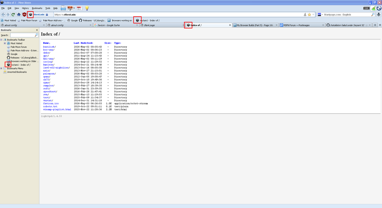

I have ported my UC.JS  script "Favicon In Url And Tab Bar", which I originally created for Mypal 78, to New Moon 28 and modified it to show the native brand icon on https://o.rthost.win/ in New Moon 28. It is of course also working in the bookmarks toolbar. :P

@roytam1 First of all, thanks for all your releases and for trying to fix the favicon issue on your server! :) Today, I have noticed that you again changed your favicon. But this doesn't work properly. Your favicon is shown in the tab and in the url bar, but not inside the bookmark in the personal toolbar. With your changes on your server o.rthost.win, I now get the following error message:
The character encoding of the HTML document was not declared. The document will render with garbled text in some browser configurations if the document contains characters from outside the US-ASCII range. The character encoding of the page must be declared in the document or in the transfer protocol.
o.rthost.win
This now appears permanently in the Browser Console because your HTML document is not configured correctly. :cool:
