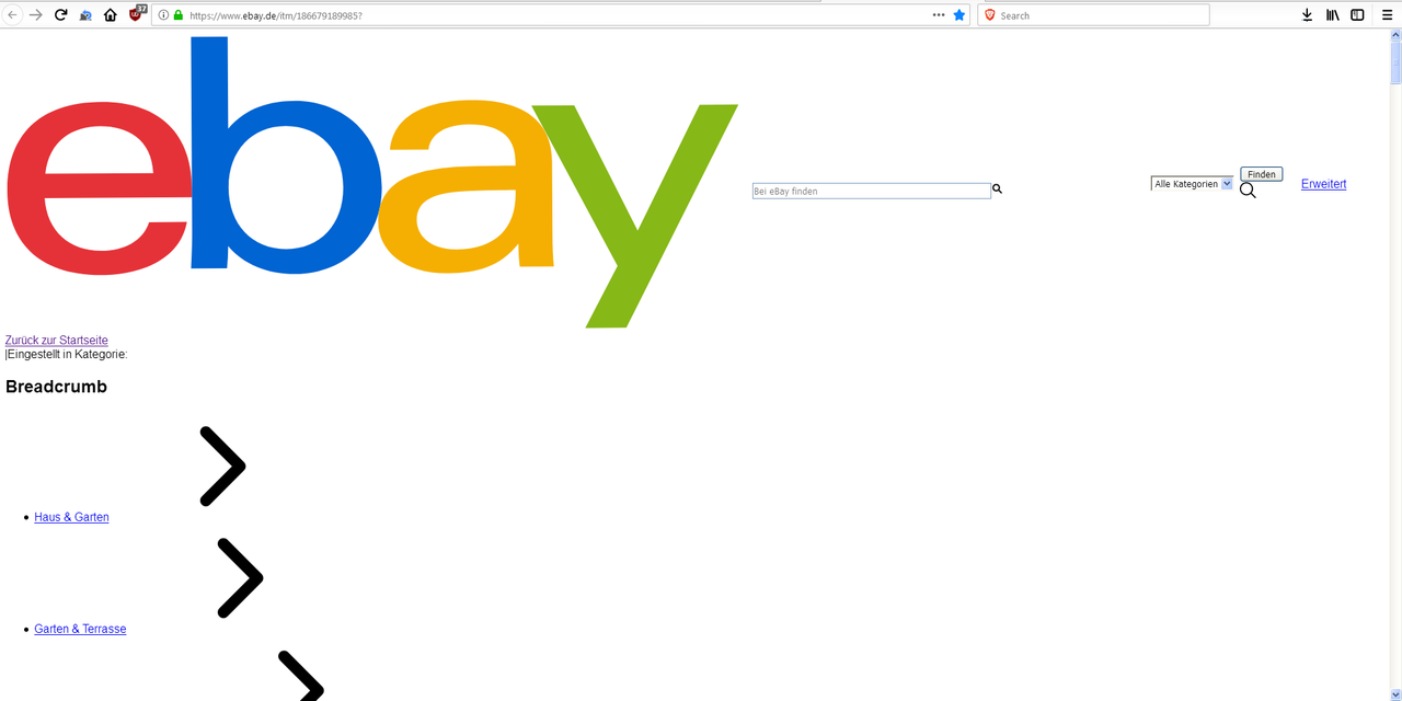

AstroSkipper Posted November 13, 2024 Posted November 13, 2024 (edited) 1 hour ago, Sampei.Nihira said: UBO Legacy has no ability to prevent URL tracking parameters. Your link should look like this (without the tracking parameters): ... Just for clarification. I know how to prevent URL tracking parameters. But the two profiles I am currently using are actually for testing and developing in New Moon 28 and Mypal 68. Apart from uBO, there is no other protection. And even this content blocker is only configured slightly, as it is not of interest. I test JavaScript and CSS files in these profiles. Mainly things I have created myself. I had searched for something on eBay there weeks ago, and now these pages no longer work as before. No more, no less. Nevertheless, thanks for replying! Edited November 13, 2024 by AstroSkipper 4

AstroSkipper Posted November 13, 2024 Posted November 13, 2024 (edited) 3 hours ago, AstroSkipper said: 4 hours ago, NotHereToPlayGames said: You need to disable -webkit-animation Unsure your best route to do so (I disable via Proxomitron). You could use a custom style sheet to override. Below should work. * { animation-delay: initial !important; animation-direction: initial !important; animation-duration: initial !important; animation-fill-mode: initial !important; animation-iteration-count: initial !important; animation-name: initial !important; animation-play-state: initial !important; animation-timing-function: initial !important; animation: initial !important; -moz-animation-delay: initial !important; -moz-animation-delay: initial !important; -moz-animation-direction: initial !important; -moz-animation-fill-mode: initial !important; -moz-animation-iteration-count: initial !important; -moz-animation-name: initial !important; -moz-animation-play-state: initial !important; -moz-animation-timing-function: initial !important; -moz-animation: initial !important; -webkit-animation-delay: initial !important; -webkit-animation-delay: initial !important; -webkit-animation-direction: initial !important; -webkit-animation-fill-mode: initial !important; -webkit-animation-iteration-count: initial !important; -webkit-animation-name: initial !important; -webkit-animation-play-state: initial !important; -webkit-animation-timing-function: initial !important; -webkit-animation: initial !important; transition-delay: initial !important; transition-duration: initial !important; transition-property: initial !important; transition-timing-function: initial !important; transition: initial !important; -moz-transition-delay: initial !important; -moz-transition-duration: initial !important; -moz-transition-property: initial !important; -moz-transition-timing-function: initial !important; -moz-transition: initial !important; -webkit-transition-delay: initial !important; -webkit-transition-duration: initial !important; -webkit-transition-property: initial !important; -webkit-transition-timing-function: initial !important; -webkit-transition: initial !important; } Thanks for your suggestion! I'll try it out later on my Windows XP computer. Since Stylus no longer works in Mypal 68, and Stylish is no longer installed in New Moon 28, I will try to inject the code into the eBay pages via the userContent.css file. No success. This does not do anything. The issue doesn't seem to be related to animations and transitions. Only when blocking ebayimg.map.fastly.net in uBO, the CPU utilisation becomes normal again. But then the page looks unusable like that: Edited November 13, 2024 by AstroSkipper 4

NotHereToPlayGames Posted November 14, 2024 Posted November 14, 2024 8 hours ago, AstroSkipper said: Only when blocking ebayimg.map.fastly.net in uBO, the CPU utilisation becomes normal again. Unable to replicate. ebayimg.map doesn't show up in any of my logs even when visiting https://www.ebay.de/itm/186679189985 incognito.

AstroSkipper Posted November 14, 2024 Posted November 14, 2024 3 hours ago, NotHereToPlayGames said: So odds are, you were not logged in at the time of copy-paste. Correct! I was not logged in at the time. The eBay link is in the format that you are offered as a simple guest. It actually only contains one real tracking component starting with _trksid, the other two are purely item related starting with itmprp (followed by a checksum) and itmmeta and are not normally filtered by tracking filters. The current URL tracking filter list inside uBO does not even clean _trksid, although it is included but not activated. 4
NotHereToPlayGames Posted November 14, 2024 Posted November 14, 2024 11 minutes ago, AstroSkipper said: The current URL tracking filter list inside uBO does not even clean _trksid, although it is included but not activated. Agreed. Same observation here. BUT here at work, I can no longer use AdGuard (URL|) Tracking Protection uBO filter lists. I've been meaning to import manually from home but haven't gotten around to it yet. So unsure if those two AdGuard lists would have removed _trksid or not.
