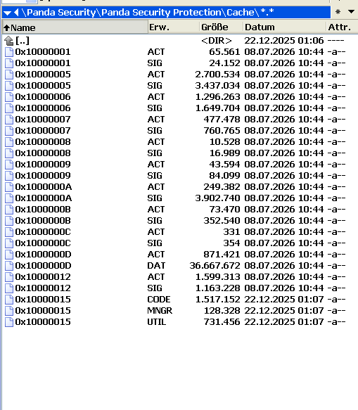

AstroSkipper Posted July 8 Author Posted July 8 (edited) @Dave-H I'm guessing you still have Panda Dome 22.03.05 installed and are dealing with that issue. However, since it seems to be running particularly poorly on your system, you might want to consider uninstalling it completely, performing a thorough cleanup, and then installing Panda Dome 21.01.00 with the option Offline Installation enabled. For me, this version vehemently refuses to let PSANHost crash. The cache folder is now also being filled correctly every day. No leftovers from previous days. Here is a screenshot showing the contents of the cache folder: Of course, I can't guarantee that it will work perfectly for you, but it's definitely worth a try. You really don't have anything to lose. Edited July 8 by AstroSkipper 1

Dave-H Posted July 8 Posted July 8 I've now tried as a test removing the cache folder completely from my Panda installation. Rather unexpectedly, the program has not recreated it. It's been running for ages now like that with no crashes, but it's not updating, presumably because it has nowhere to put the files! Doing a manual update from the option in the settings does nothing. I guess I could leave it like that, but of course, like the version of Malwarebytes I used on XP for years, it will eventually become useless for protection because of no updates. I tried Avast on my system a few years ago and never got it to work on my desktop system. Even the supposedly compatible version for XP would not run, its core service obstinately refused to start, reason unknown. I even worked with Avast's technical support people about it, and even they couldn't determine what the problem was. I tried a test install on my netbook under XP, and that worked perfectly, so what the problem was with the desktop remains a mystery. 2
AstroSkipper Posted July 8 Author Posted July 8 5 minutes ago, Dave-H said: I've now tried as a test removing the cache folder completely from my Panda installation. Rather unexpectedly, the program has not recreated it. It's been running for ages now like that with no crashes, but it's not updating, presumably because it has nowhere to put the files! Doing a manual update from the option in the settings does nothing. I guess I could leave it like that, but of course, like the version of Malwarebytes I used on XP for years, it will eventually become useless for protection because of no updates. That’s, of course, the ultimate way to block incompatible updates. But that wasn’t what I suggested. Not keen on Panda Dome 21.01.00? It’s running without any problems for me at the moment. 1

AstroSkipper Posted July 8 Author Posted July 8 18 hours ago, AstroSkipper said: On 4/29/2023 at 6:02 PM, AstroSkipper said: Legacy offline installer for version 22.03.05: http://acs.pandasoftware.com/Panda/FREEAV/Promo_pd/FREEAV_LGC.exe Here is a website where you can get the old offline installer of version 21.01.00: https://panda-free-antivirus.sooftware.com/windows/download/338378 @Tangy Perhaps you can try Panda Dome 21.01.00. I am under the impression that this version is working better on Windows XP. It's definitely worth a try. @Dave-H That's what I replied to @Tangy. 2
Tangy Posted July 8 Posted July 8 @AstroSkipper Panda 21 is working without any problems what so ever, so far so good. I reckon it is the best choice ever. I do have Avast 18.5 but I would never go back to it. Kind of dodgy. Thank you very much indeed !
