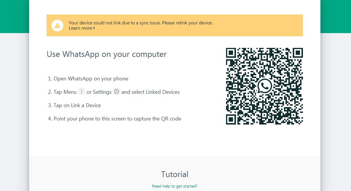

I always used Basilisk because it is stable on my system and all the extensions I use work perfectly. Today I downloaded the latest update -always grateful Roytam1- and the only site I can't get to work is WhatsAppWeb.
Sorry if this is a normal bug or you were discussing it in a separate thread. I've been away for a long time and I can't find any info about it.
Any help? I leave a screenshot just in case.
if you have newer OS environment, you may test with official PM32.1 to see if whatsapp is working on official build or not. and report to them if it doesn't.
and FYI: mypal68.13 works (with general.useragent.override.web.whatsapp.com="Mozilla/5.0 (Windows NT 6.3; WOW64; rv:78.9) Gecko/20100101 Firefox/78.9" (without quotes) in about:config)
No, I'm still with my old XP, as always. I tried to use PM but it doesn't work at all on my system. It won't even start.
