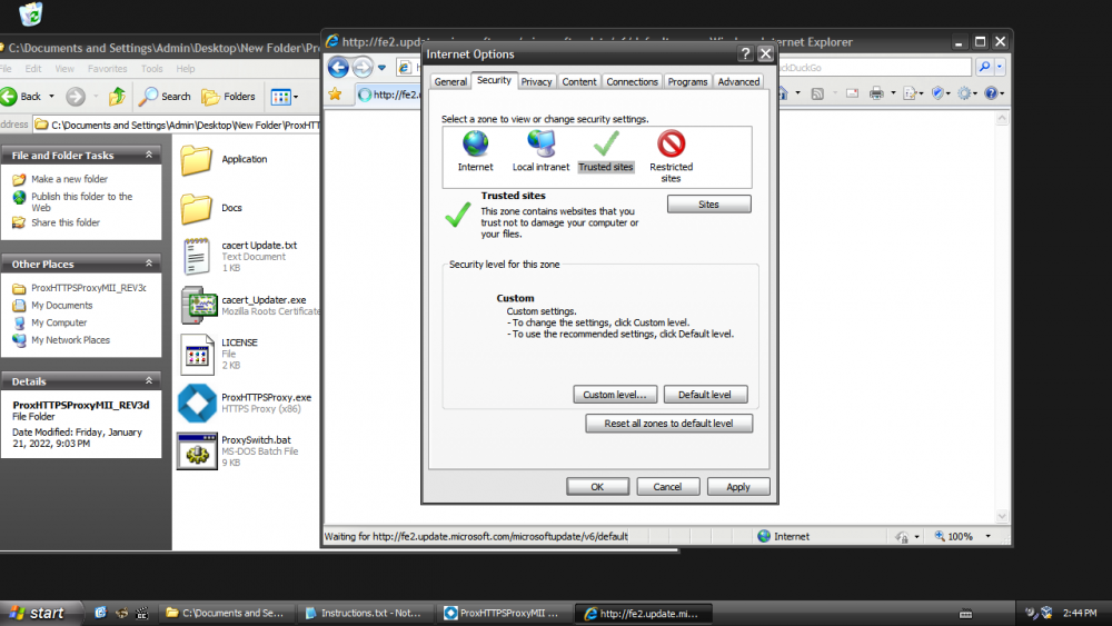

AstroSkipper Posted June 2, 2023 Author Posted June 2, 2023 (edited) @Outbreaker I changed the thread because we are talking about problems in terms of accessing MU/WU. The other thread is about TLS proxies. Therefore, post your further problems here! 1 hour ago, Outbreaker said: The sider to set the Trusted Zone to High was not displayed and i had to click "Default Level" for it to show up. 🙄 Now i can access the Windows Update page but when i try to scan for updates i get an error. You have to set the slider to High in your Trusted Zone, otherwise it won't work. Only with the three mentioned URLs inside! If you can't set it to High, you should reset your Internet Explorer completely. Please provide screenshots from your IE settings and screenshots from issues shown when accessing Microsoft Update! Are there any error codes (in the right corner of the MU website)? Edited June 2, 2023 by AstroSkipper 2

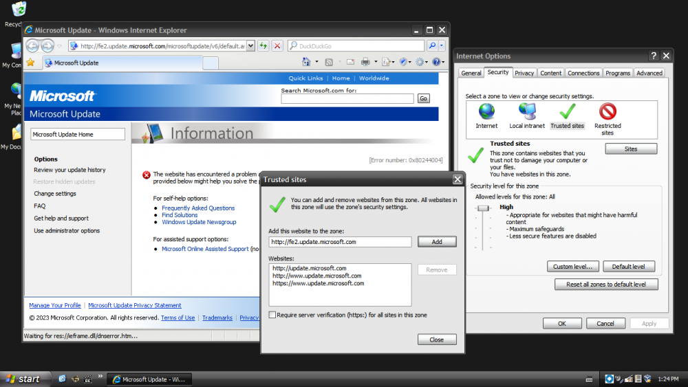

Outbreaker Posted June 2, 2023 Posted June 2, 2023 Here is the Screenshot. I also tried to reset the Internet Explorer 8 but this didn't help. It's also a new installed Windows XP.
AstroSkipper Posted June 2, 2023 Author Posted June 2, 2023 (edited) 36 minutes ago, Outbreaker said: Here is the Screenshot. I also tried to reset the Internet Explorer 8 but this didn't help. It's also a new installed Windows XP. You are getting error code 0x80244004. If so, you should check or perform step 11 once more. You have to verify the existence of patched "wuaueng.dll" in the mentioned folders of my guide. Be aware of SFC which tries to restore an original old version of this file! After patching, restart your computer and check again! Anyway! Doing all steps correctly and keeping the order should let the probabiliy of success increase to nearly 100%. Edited June 2, 2023 by AstroSkipper Update of content 2
AstroSkipper Posted June 2, 2023 Author Posted June 2, 2023 @Outbreaker In your last screenshot, I could see that the security level of Trusted Zone was set to High. That's what it should be. So why did you say the level couldn't be set to High? 2
Outbreaker Posted June 2, 2023 Posted June 2, 2023 (edited) Okay everything is working now after applying the patched wuaueng.dll file.😱 I would also add the Internet Explorer settings to the "Restore_WU_XP_DE.7z" tool too. 😏 41 minutes ago, AstroSkipper said: @Outbreaker In your last screenshot, I could see that the security level of Trusted Zone was set to High. That's what it should be. So why did you say the level couldn't be set to High? The slider bar to set the Trusted Zone to High was not visible for me. Only after i pressed on the "Default level" it showed up. 😒 Edited June 2, 2023 by Outbreaker 1
