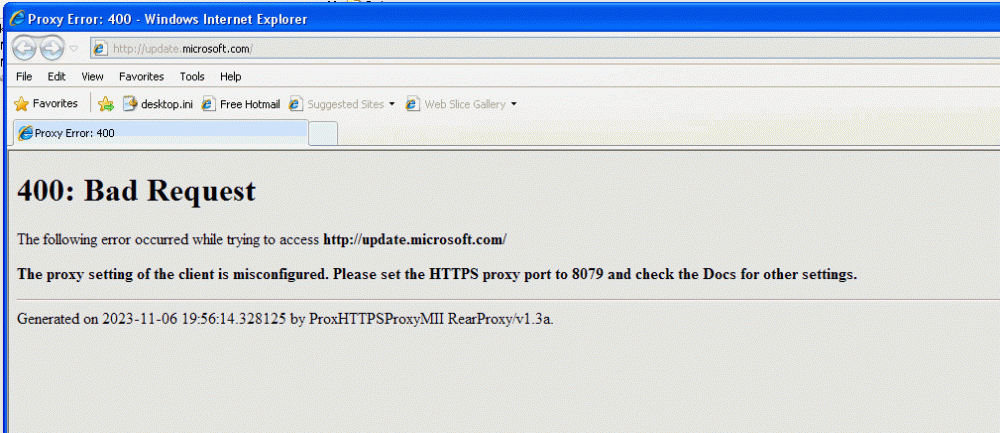

@WSC4! That's not going to work. :no:
5 hours ago, WSC4 said:
I am running Windows XP 64-bit, and I have studied your post that you posted over a year ago.  I have downloaded the file and installed it and the WU Patch and have done everything that you said to do.  This is what I get when running Windows Update:
Are these setting correct?  Any help on this please?
Why are you trying to access the url http://update.microsoft.com/:dubbio: This is not the correct link and will only end in an error page. Did you read the whole documentation? Here is a link:
Under point 18, you will find the links you need to call up: http://fe2.update.microsoft.com/microsoftupdate/v6/default.aspx?ln=e or http://fe2.update.microsoft.com/microsoftupdate/v6/default.aspx?ln=en&g_sconsumersite=1
But I recommend to read the whole documentation first to avoid further problems. Using this method to access MU/WU means that all components have to be configured 100% correctly. And please note that I have written my instructions mainly for Windows XP 32-bit! This means that a few steps can be skipped under Windows XP 64-bit. But you will realise this if you read everything carefully.
