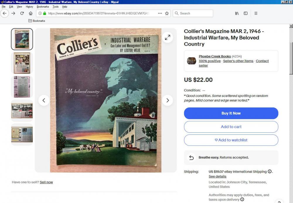

The other day, I started having troubles using eBay.com. Several buttons on the listing pages like Buy It Now and Add To Cart were no longer functioning - i.e the arrow cursor didn't change to a hand cursor to be able to select the buttons. In addition, I could no longer select a different view of the item or expand the photo using the magnifying glass.
I tried deleting my browser cache and cookies first - but that didn't make any difference. I also tried upgrading from MyPal 68.13 to MyPal 68.14. (I'm using the 32-bit version.) That didn't make any difference either.
Does anyone have a suggestion how to fix this problem? I'm wondering if there's a setting in MyPal I should be adjusting.
First, the bad news (unfortunately, for you). ebay.com does not work for me in Mypal 68.14.0b, either. The buttons are inaccessible. The good news (fortunately, for me) is ebay.de is still working. All buttons are functional and accessible. Maybe, there is a preference which can be set in Mypal 68.14.0b. :dubbio: I don't know at the moment. I had a look into the web console, and there are JavaScript errors. Something must have been changed. I therefore think this can probably only fixed by @feodor2. The good news (for you) is that in New Moon 28, all is still working. :thumbup Just tested. :P
PS: BTW, this issue was already reported to the issues of Mypal 68 here: https://github.com/Feodor2/Mypal68/issues/228#issuecomment-2080375184

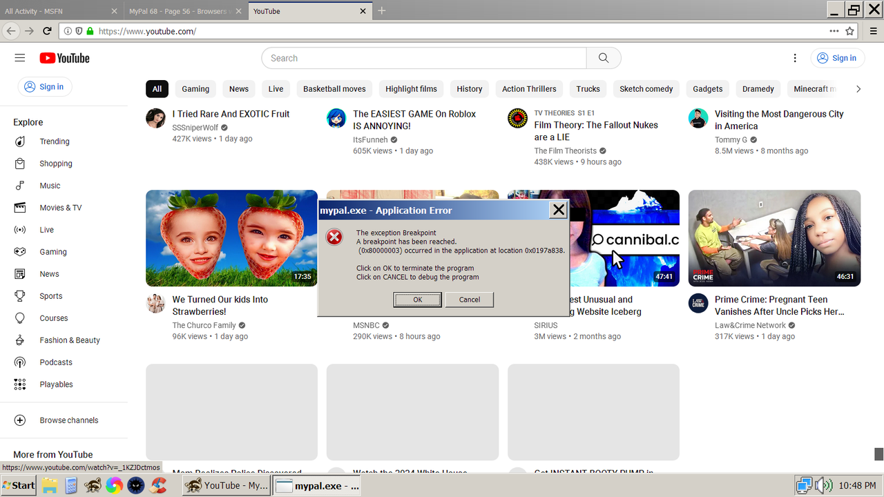

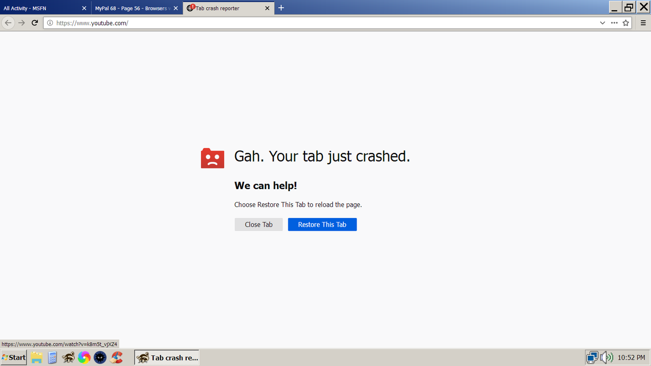

1 hour ago, LoneCrusader said:
...Also, I can confirm the random crash on YouTube main page reported on GitHub on at least one of my machines (this machine is XP SP4 x86). All you have to do is go to the main page and "scroll down" for a while looking through what's available; sooner or later it will die.
Ok ... we never said the random crash and from where before, so I did what you said 3 times and all 3 times going through several pages it indeed crashed.
Restore the tab and we're back in business only to have the same thing happen after scrolling down pages and eventually it does crash, but since I'm in multi-process mode the browser doesn't totally crash just the tab.
Make sense @feodor2? I hope you will (I know you will) figure it out because this is over my head. I've been testing with the previous version and this does not happen only in 68.14.0b
