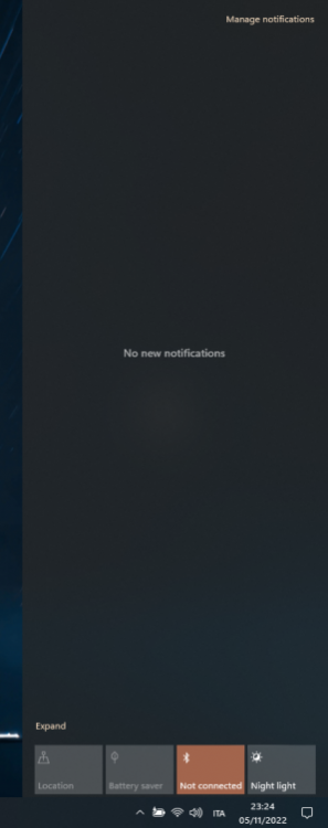

SomewhereNowhere Posted December 2, 2022 Posted December 2, 2022 (edited) On 11/6/2022 at 12:02 AM, SomewhereNowhere said: i noticed that enabling the windows 10 action center by creating the dword "UseLiteLayout" 1 in "HKLM/Software/Microsoft/Windows/Current Version/Control Center/" on latest 22621 with startallback the 10 wifi flyout buttons disappear thus make them unclickable Any news about this bug being fixed? Edited December 2, 2022 by SomewhereNowhere
