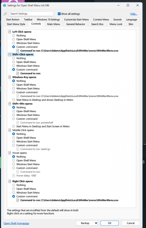

Hello,
I'd like to suggest a cool idea from OpenShell - customize start button actions:
That way we can trigger multiple start menus or even other files, which opens a ton of cool possibilities.
