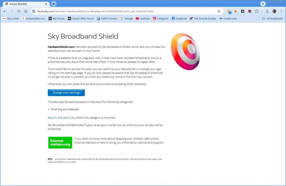

Dave-H Posted May 13, 2025 Posted May 13, 2025 Be aware that hardwarefetish.com is blocked by my ISP as a malware/phishing site. Proceed with great caution if you visit it!

Dave-H Posted May 18, 2025 Posted May 18, 2025 14 hours ago, Multibooter said: You should be able to access the hardwarefetish.com pages via archive.org, e.g. https://web.archive.org/web/20250000000000*/http://hardwarefetish.com/524-paragon-gpt_loadersys-bsod-analysis-and-fix The info at hardwarefetish.com about Paragon GPT Loader seems reliable to me, the best info around. hardwarefetish.com is apparently the home site of "dose" [Austrian beer can? ] who prepared several bug fixes of GPT loader, long after Paragon gave up on it. This home page has apparently not been changed over from http to https, so that you may get an "Untrusted Connection" warning or 404 etc if you load it via https, e.g. https://hardwarefetish.com/ Thanks, yes, I did access it through the Wayback Machine. This is what I'm seeing if I try to access it normally - As you can see, it's not a browser block or security software block, it's a block by the ISP at source, which I've very rarely seen!
