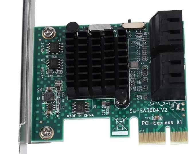

I now have this card.
I tried to find the two port version, but no luck anywhere, so I had to get a four port one.
As said, in the 'no boot' mode, it appears in XP as an IDE controller.
The only problem is that it keeps on trying to install another IDE controller, and when the driver is being installed, the system just freezes permanently.

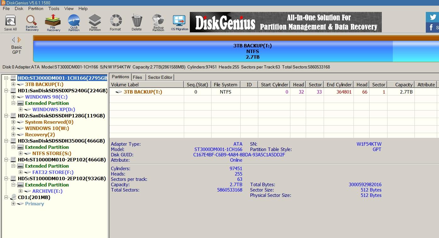

This is how it's seen by Disk Genius in XP.
Of course, it's much too early to say whether it will be reliable in actual use, but it's looking quite hopeful!
It does have more than 2TB of data on it.

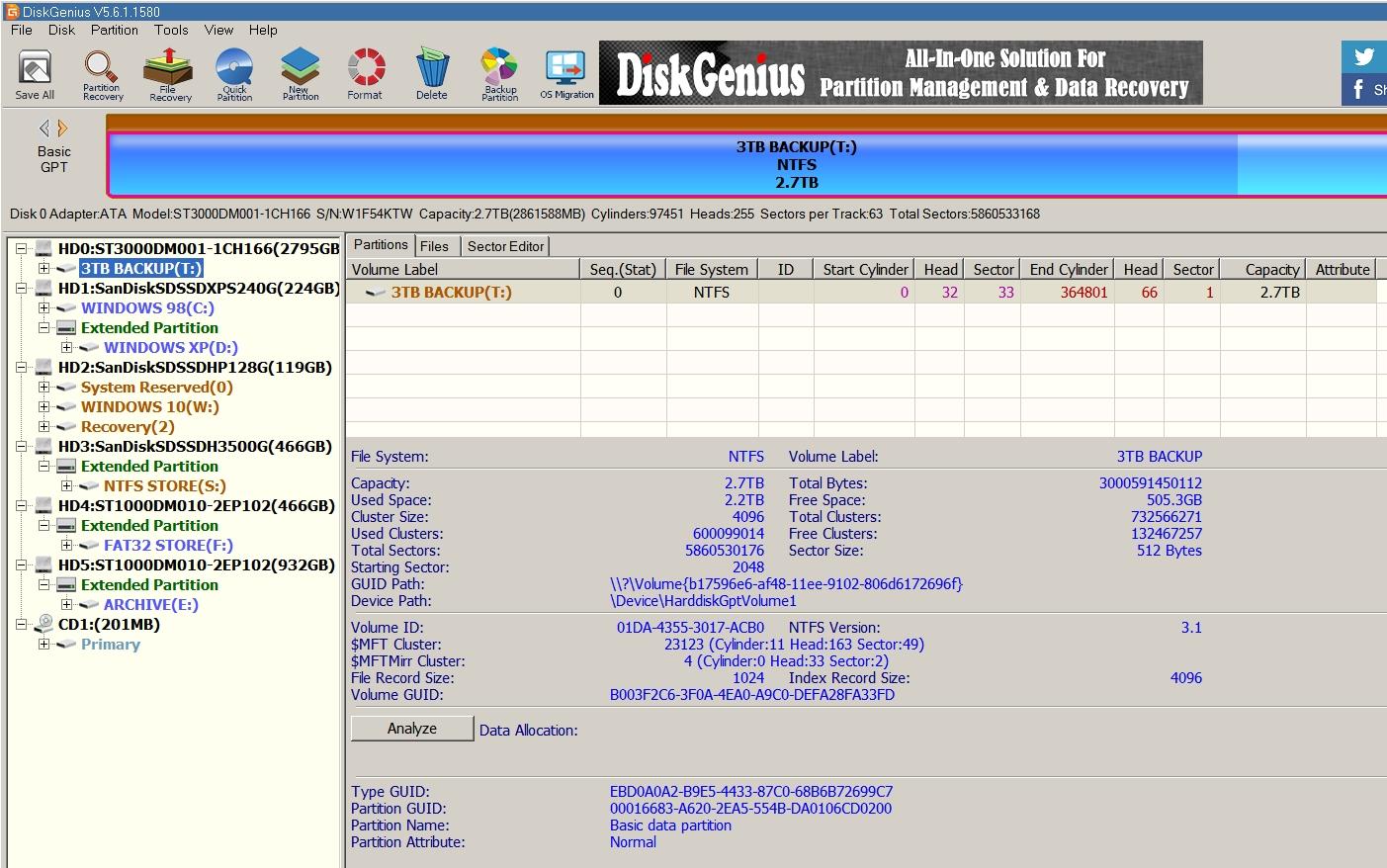

Below an image of my 4TB GPT disk connected to the sata port of the same card ordered by @Dave-H. In the Device Manager the card is listed under "Standard Dual Channel PCI IDE Controller". Its Hardware ID is "VEN_1B21" and "DEV_0611" that identify an Asmedia device. The system is configured in AHCI mode and the sata/ahci driver is the IRST v11.2.0.1006 installed for the Intel sata controller. The GPT HDD is almost full and I have checked all the files on it without finding any problems:
This is an image of the drive as detected by Disk Genius:

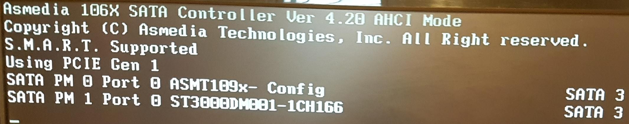

If I run the card in 'No boot' or IDE mode, there is no BIOS text on boot, but if I run it in AHCI mode, I see this -
That shows the 'phantom' disk, labelled 'ASMT109x- Config'.

With the card selector set to "AHCI Boot" in the pre-boot phase I get a screen almost the same as the one you posted. The only difference is the indication "Using PCIE Gen2" instead of "Using PCIE Gen1".
Also in my case the words "SATA PM 0 Port 0 ASMT109x- Config" are displayed.

I tested again the ASM1061 board with 4 SATA ports on my Msi Q87 board configured in IDE mode.
Once booting is completed, the system detects the PCI card but can't find any compatible SATA/AHCI drivers. Intel's two IDE controllers are listed in Device Manager, while the Asmedia PCI card is among the non-installed devices:
When the selector is set to "No Boot" mode, the card is automatically installed in the system. In the following image, the Asmedia IDE controller added to system is one regardless of the presence of 4 SATA ports:
Below is the image of my other ASM1061 card with two SATA ports installed on the same Q87 board:
the Device Manager is identical to that for the board with 4 SATA ports. No other device was detected for both cards.
Reading the characteristics of the ASM1061 chipset seems that the available SATA ports are two:
https://www.asmedia.com.tw/product/77BYq58SX3HyepH7/58dYQ8bxZ4UR9wG5
A concern of mine is again confirmed: it is never a given that a device that works in one system will also work on another system, unfortunately :(
Thanks @Andalu, that's amazing research!
:worship:
Off-topic again, but I've now configured the card as an IDE controller on Windows 10 as well by changing the driver, and it's all working great.
So, the only thing that's not good now is having to dismiss an add hardware window every time I boot XP.
If I do anything else with it, the system just freezes permanently,
What's mainly puzzling me is why it's being found as another IDE controller, when it's already installed as one, and I can't see that anything's missing!
:dubbio:

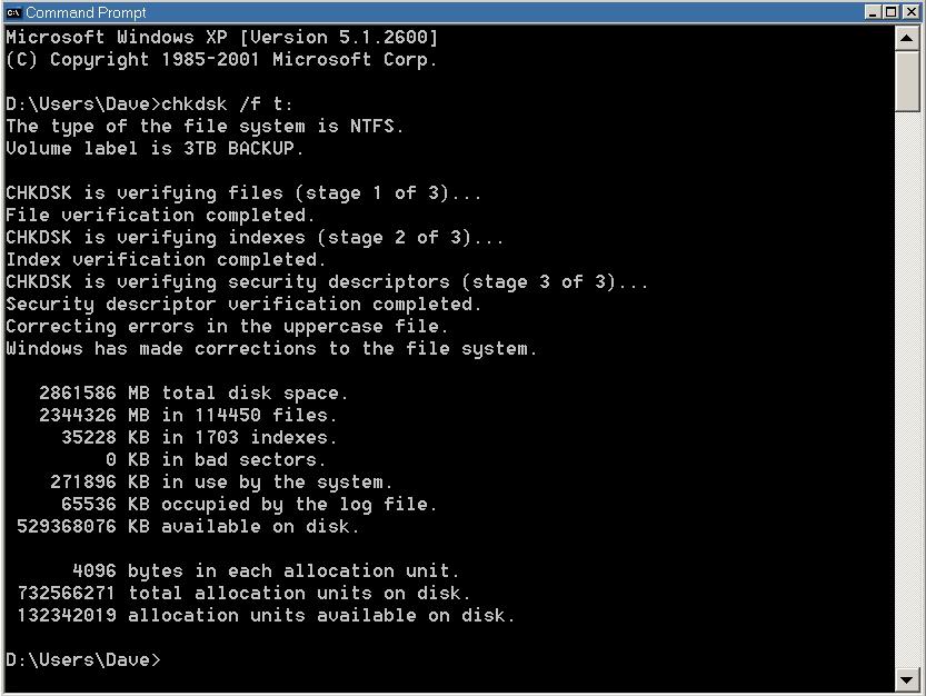

8 hours ago, Dave-H said:
Anyway, to get back onto topic, things look good with the 3TB disk with this configuration.
If works fine, and I've written to it using Windows XP and Windows 10, and there is no sign of any corruption apart from when I check in Windows XP after being in Windows 10, CHKDSK says it's "correcting errors in the uppercase file".
I have no idea whether this is anything to worry about or not, but it's certainly nothing like the huge list of index corruption errors I was getting before!
:thumbup
