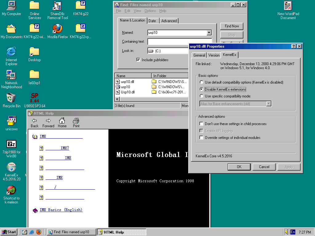

@jumper
I found that ServicePack for WIN98SE corrupts the Uniscribe, and that's why my browser can not display text.
~♥Aiko♥Chan♥~ If Html5Test shows ticks and crosses etcetera in Opera 12 or FF9 then it is not for lack of fonts but more of a out of memory error. Later versions of Mozilla beyond 9 operated faster adding more resources to video driver but also froze screen. Best I had in the day for CometBird 11 was able to view up to 4 min approx Youtube videos on auto play any longer video and it froze. This was experimenting with a combination of vs 9 and vs 11 files within omni.ja. The XUL.dll created an overload in memory allocation somewhere to do with hardware driving in my estimation. Some people had trouble with FF10 (in win2K I assume) and likened it to a memory leak.
ABCDEFG Did you read my post on https://msfn.org/board/topic/173233-kernelex-45-core-updates-45201617/?do=findComment&comment=1163422  about this. There are 2 posts starting about 3/4 down on page.
Edited by Goodmaneuver
^Goodmaneuver which post? Can you link it please?
I see now, but disabling Kex on Usp10.dll do not help.
I installed 98se to another VM but without SP and there it works.
