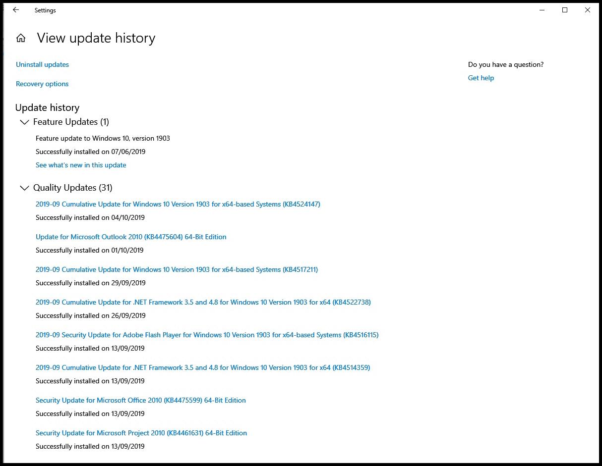

Dave-H Posted October 5, 2019 Author Posted October 5, 2019 On 10/3/2019 at 6:38 PM, roundball said: All it does is post that normal "Failed to install" phrase. And when I double click the highlighted phrase there's nothing unique under it. ( just the normal "This change if for fixes and security, blah, blah, blah ) I appreciate that you took time to offer some help...I'll just "hide" this thing for a while, thank you again. @roundball Sorry for the delay, but this is the Windows 10 update history list I was referring to. Your failed installed of the Office 2010 update for Outlook should be listed there (as mine is) with an error code if it failed. I do realise this Windows 10 stuff is off-topic here! 1
roundball Posted October 5, 2019 Posted October 5, 2019 2 hours ago, Dave-H said: @roundball Sorry for the delay, but this is the Windows 10 update history list I was referring to. Your failed installed of the Office 2010 update for Outlook should be listed there (as mine is) with an error code if it failed. I do realise this Windows 10 stuff is off-topic here! Yes, the failure posts there but there is no error code. I've got it safely tucked away [ "hidden" ] and I'll try it again in a month in case MS has done any tweaking to it. Thank you again...
Dave-H Posted October 6, 2019 Author Posted October 6, 2019 OK, no problem, I'm sure the failed update will soon be superseded by another one, indeed perhaps next week! I hope that whenever the next one is that it does install OK for you. Strange to have a failure with no reason or error code given though. Cheers, Dave.
